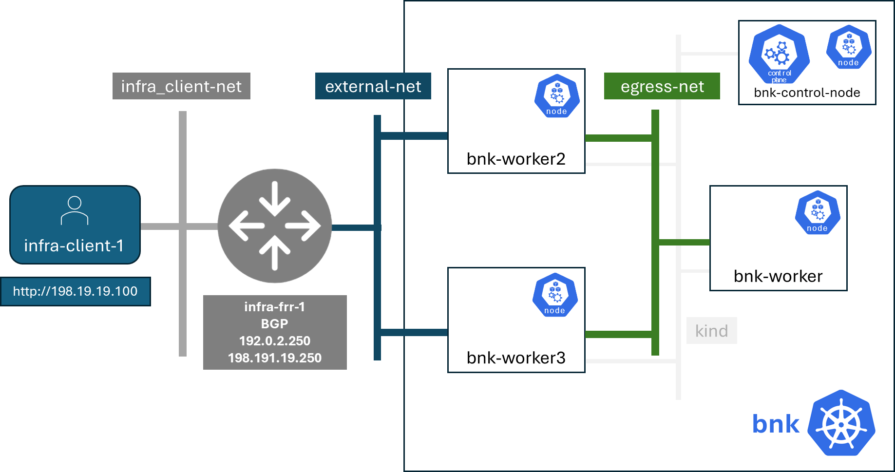

BIG-IP Next for Kubernetes is modular and can be deployed at various scales. Our lab development environment will take advantage of KinD to build a Kubernetes cluster in a single virtual machine.
Our lab network diagram will look like this when we are done:

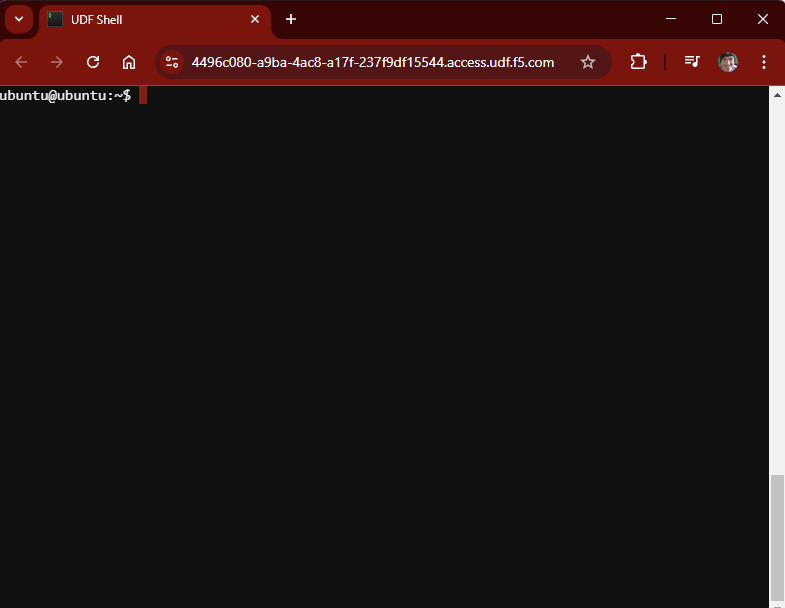

We will access the lab through web console user interfaces supplied per student. The link to your web console will be provided in the lab.
../../_images/USDWebConsoleUI1.png
Login to the web user interface, change to the ubuntu, non-privileged user.
Switch user
 su -l ubuntu

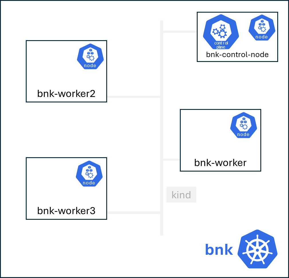

Notice that KinD added its own network to connect the Kubernetes node containers which has its own bridge on the virtual machine host.
Let’s look at the docker networks now:
List Docker networks
 docker network ls
The output should look like this:
Docker networks Output
NETWORK ID     NAME      DRIVER    SCOPE
938d048cb58f   bridge    bridge    local
a7e18706eb7a   host      host      local
01c75852c676   kind      bridge    local
3ac8b0046fd9   none      null      local
Here is where we are now:
../../_images/KinDDeployedLabEnvironment1.png

Now our lab environment looks like this.
../../_images/InfrastructureRouterandClientinLabEnvironment1.png
Our lab environment is complete. It mirrors all the standard components of a Kubernetes environment. It is now time to deploy BIG-IP Next for Kubernetes.
