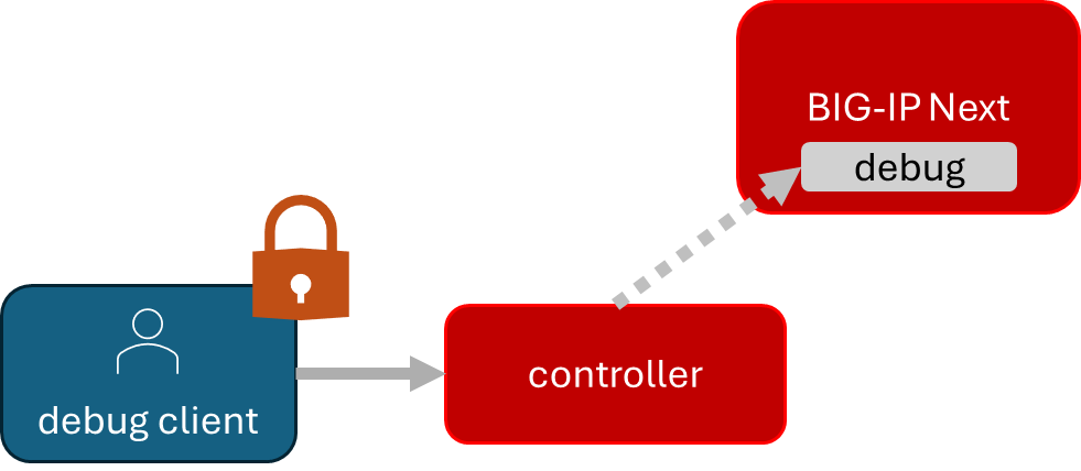

Enable BIG-IP Next debug service access
We need to create a way for clients outside the cluster to create secured communications for debug services inside the cluster. This external access will allow you do get product information, do licensing reporting, collect qkviews for support, and have access to debug traffic.
These credentials will be stored in Kubernetes secrets, but we will also copy the credentials to files in the virtual machine host so we can use them for a demonstration an debug API access. We will do this in lab three.
../../_images/CWCAuthgenerationfordebugAPI1.png
We need to create these credentials before we install everything for BIG-IP Next for Kubernetes, please run the command:

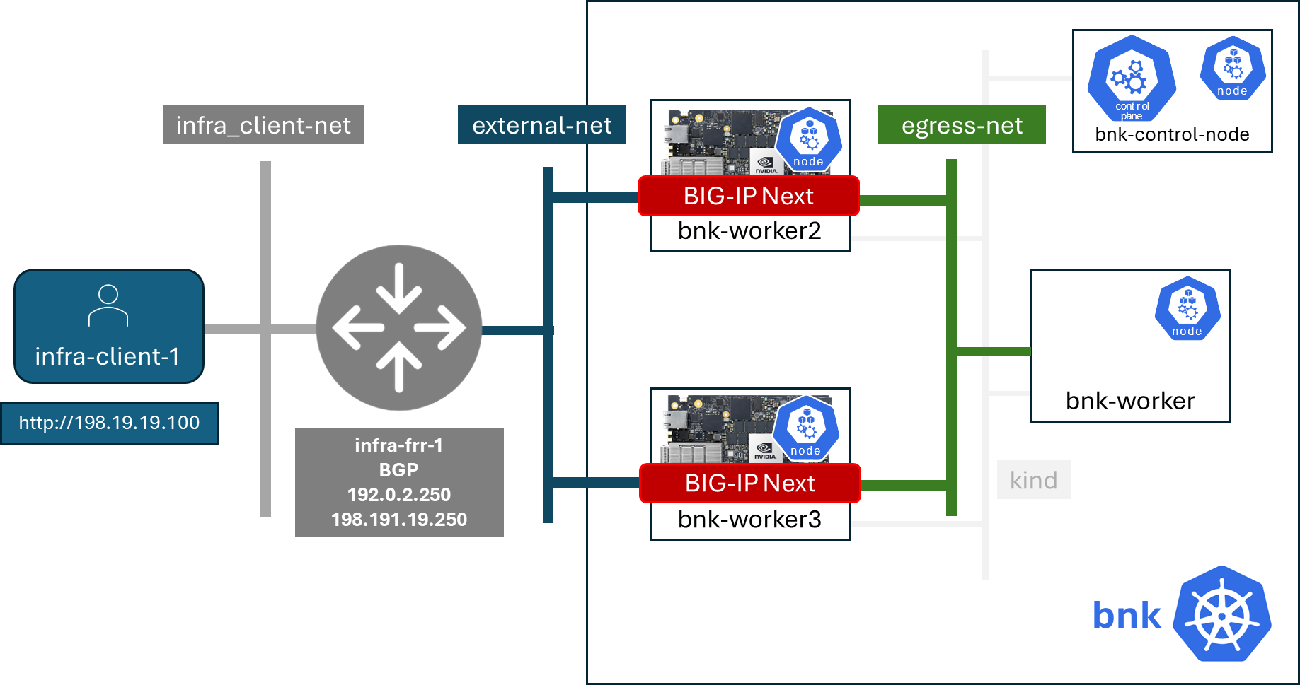

That’s the last prerequisite environment resource we need. Let’s install BIG-IP!
Install a BIG-IP Next for Kubernetes deployment
We will use Helm to install our OLM compliant operator which will then orchestrate dynamically the lifecycle of the BIG-IP Next for Kubernetes components. That’s why operators are cool. They are orchestrators which run constantly in your Kubernetes clusters doing their job for you.
Let’s run the script for installation:
Install BIG-IP Next for Kubernetes
./install-bnk.sh
Installation output:
Install BIG-IP Next for Kubernetes Output

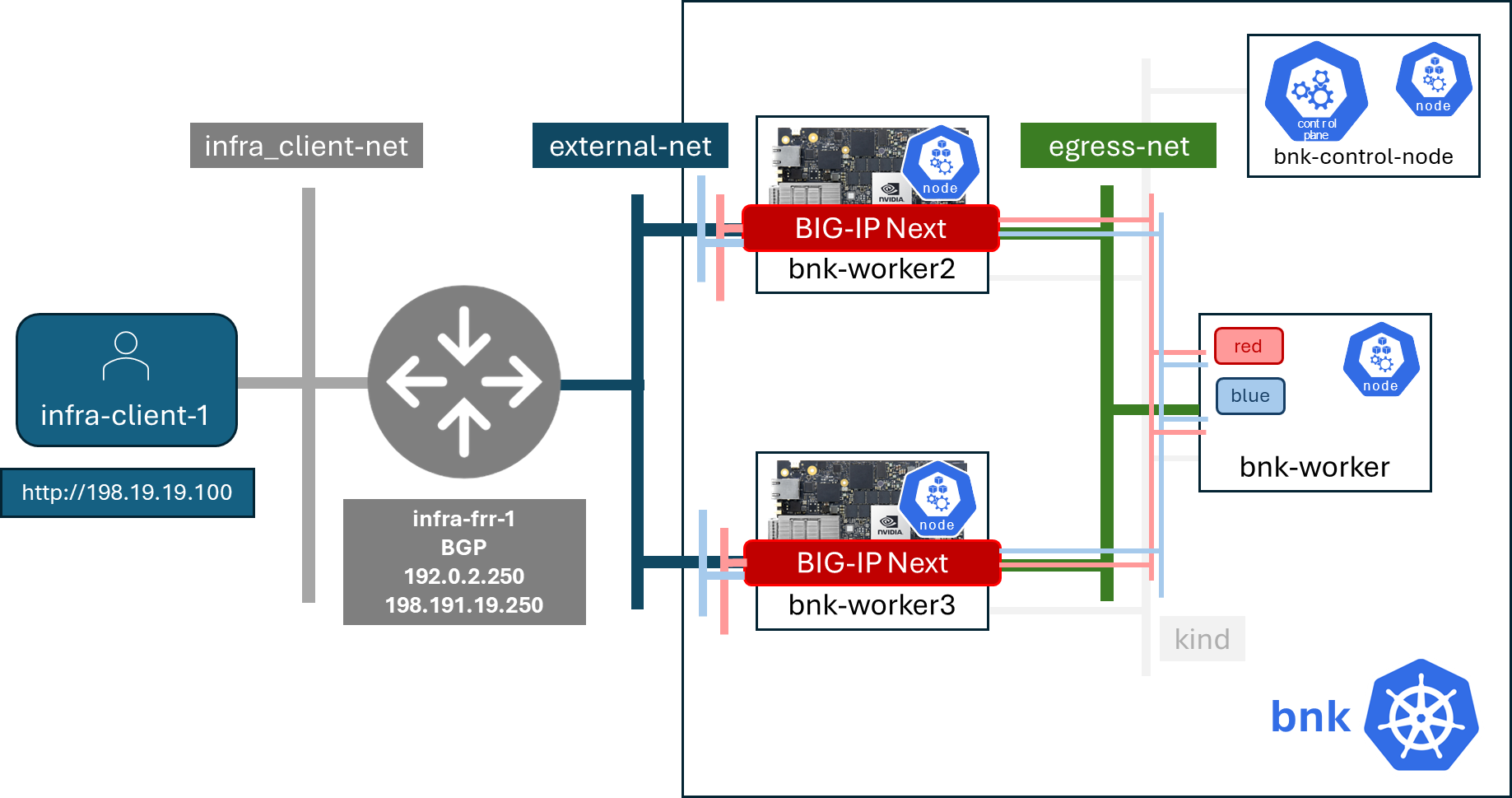

Wow.. label nodes for BIG-IP Next installation.. install the orchestration.. BOOM.. Install.
../../_images/BIG-IPInstalledLabEnvironment1.png

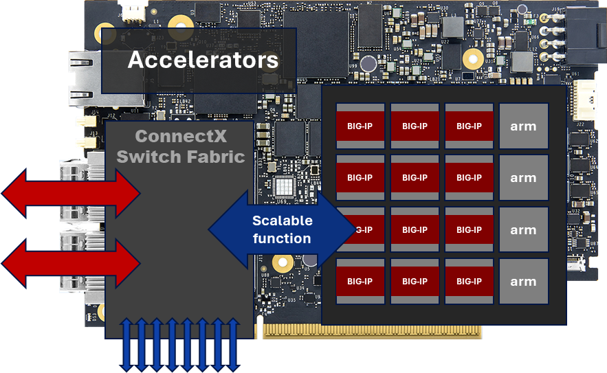

Class Discuss: BIG-IP Next for Kubernetes on NVIDIA DPU nodes
In the above installation we labeled two nodes and pretty much dedicated these nodes to BIG-IP Next. We don’t need to do this, but this illustrates how a NVIDIA DPUs would look.
../../_images/BIG-IPNextonNVIDIABF-3Diagram1.png
When you enable the NVIDIA BlueField-3 in DPU mode, it shows up as a separate node in your cluster. We label those nodes the same way we did in our install and the operator does the install as it would.
../../_images/BIG-IPNextonNVIDIABF-3KubernetesNodes1.png

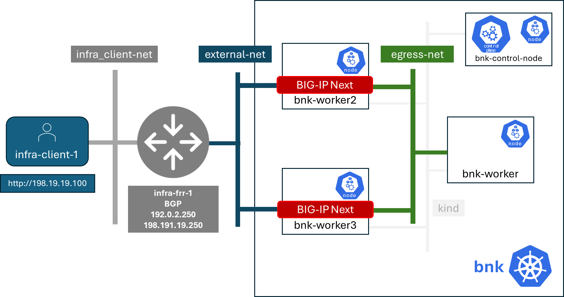

Create Kubernetes tenant networks for ingress and egress
You will now create the tenant networks for the blue and red tenants by running:
Create Tenant Networks
./create-tenants.sh
Viewed output:

We just created ingress and egress network for blue and red tenants.
../../_images/TenantIngressandEgressNetworks1.png
We successfully install BIG-IP Next for Kubernetes and setup two infrastructure tenant networks.
