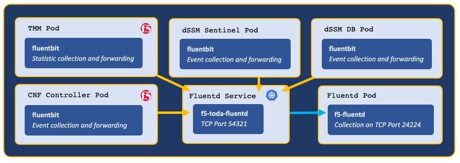

Fluentd Service¶
When installing Fluentd, a Service object is created to receive logging data on TCP service port 54321, and forward the data to Fluentd on TCP service port 24224.
Example Fluentd Service:
Namespace: cnf-gateway
IP: 10.109.102.215
Port: <unset> 54321/TCP
Endpoints: 10.244.1.75:24224
Example Fluentd integration:
