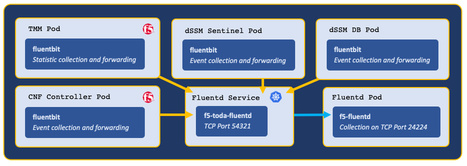

Example Fluentd integration:
_images/cnf-fluentd-logging.png
