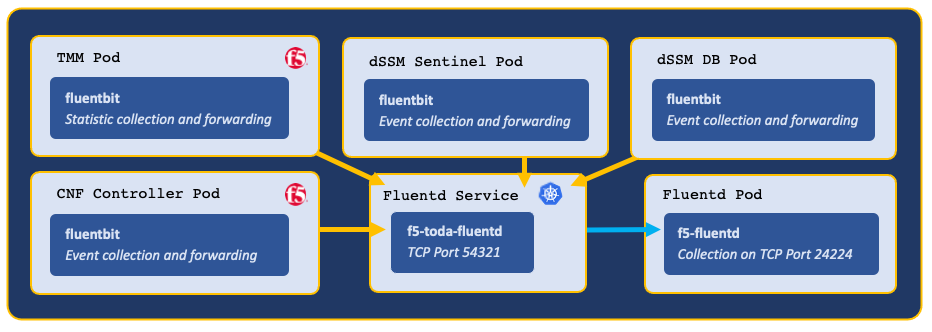

Fluentd Service
When installing Fluentd, a Service object is created to receive logging data on TCP service port 54321, and forward the data to Fluentd on TCP service port 24224.
Example Fluentd Service:
Namespace:         cnf-gateway
IP:                10.109.102.215
Port:              <unset>  54321/TCP
Endpoints:         10.244.1.75:24224
Example Fluentd integration:
_images/cnf-fluentd-logging.png
