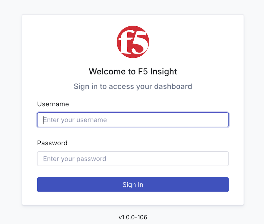

Verify the system is working on both instances. Record their IP addresses, for example:
  • Primary: 10.145.18.134
  • Standby: 10.145.16.150
F5 Insight login page

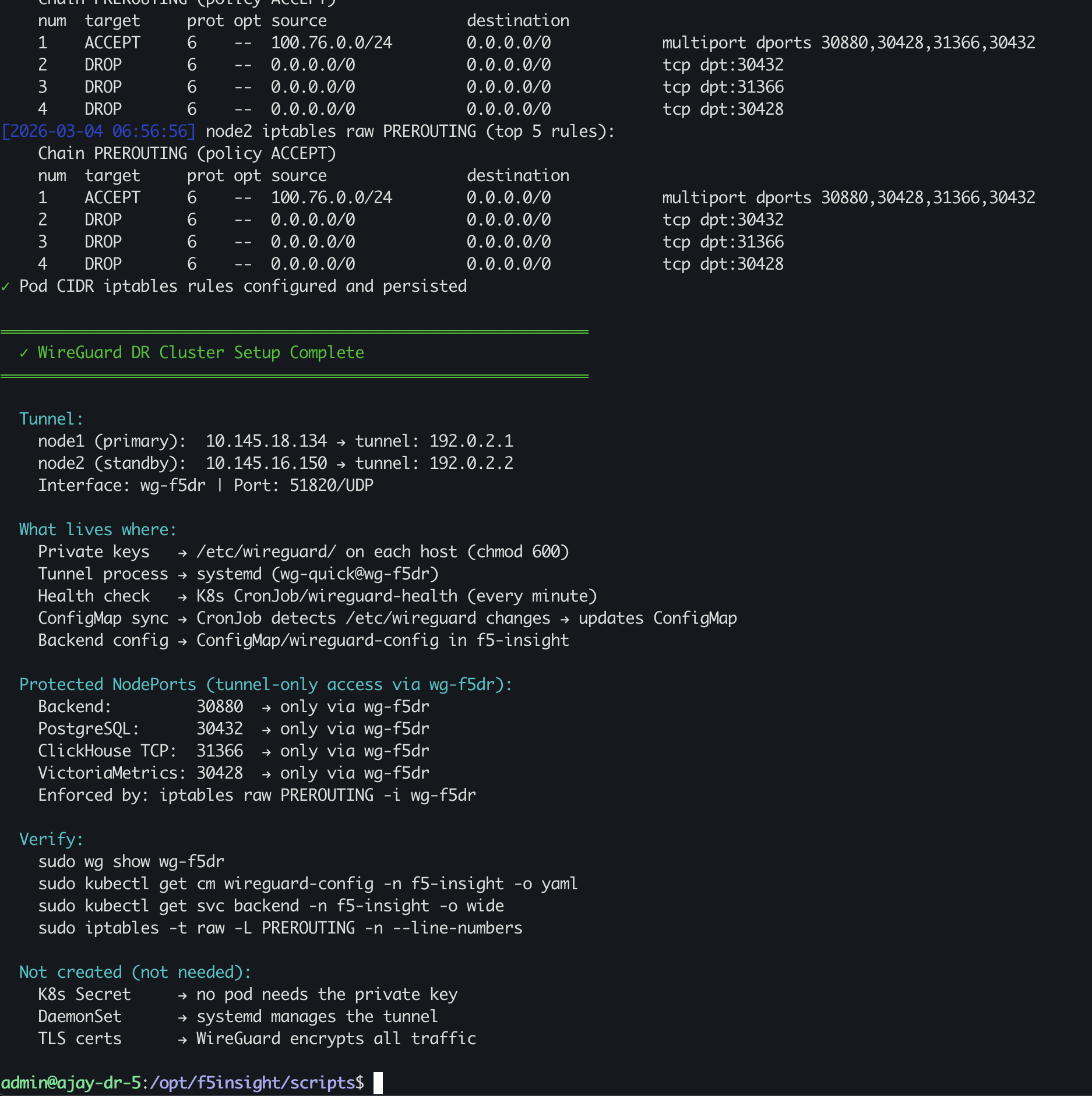

Set up the WireGuard tunnel
  1. Log in to the primary instance through SSH.
  2. Go to /opt/f5insight/scripts.
  3. Run the WireGuard setup script to:
    • Generate keys.
    • Establish the tunnel.
    • Configure iptables rules.
Once complete, a confirmation message displays.
WireGuard setup

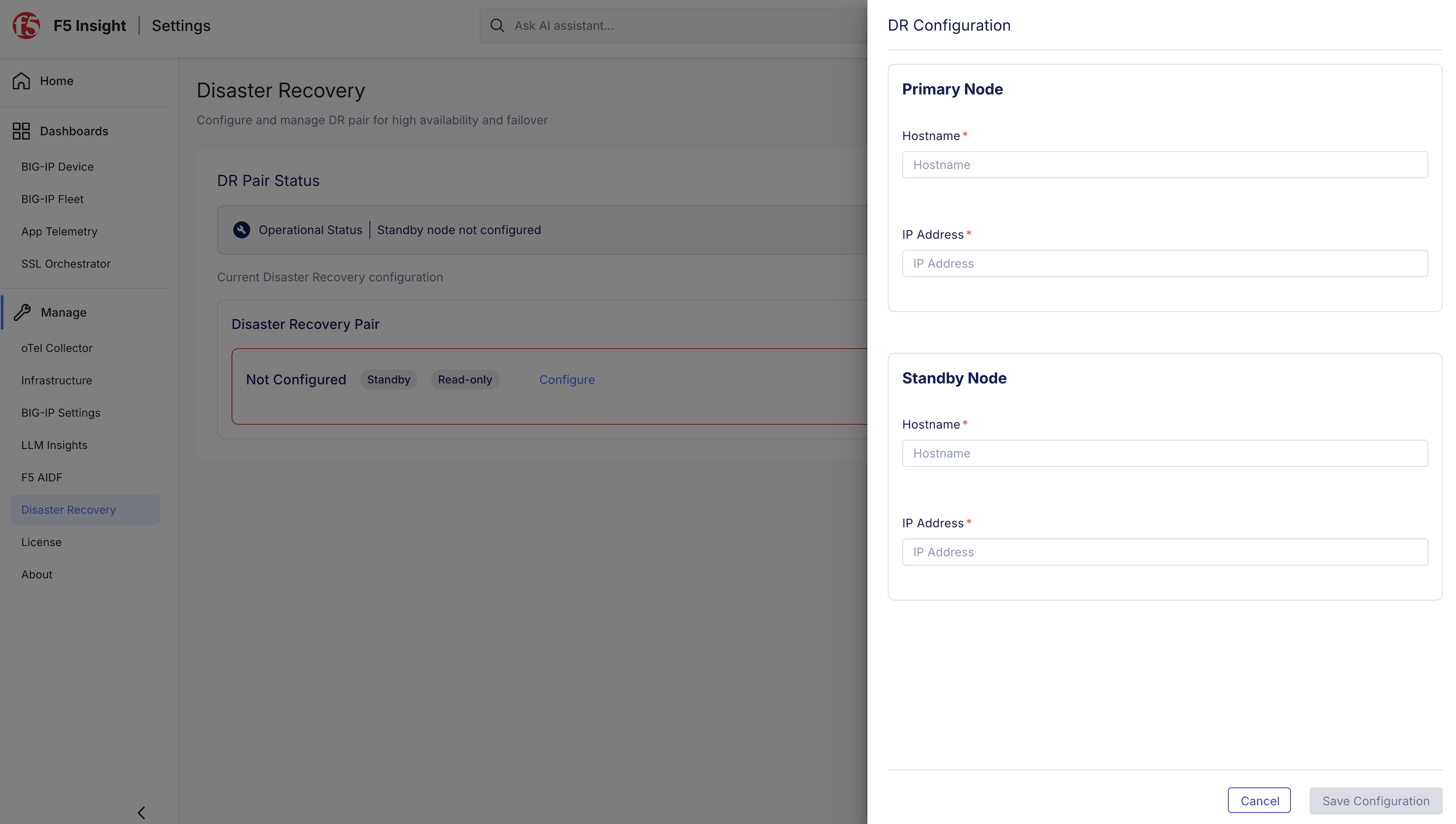

Set up DR in the UI
  1. Access the primary instance web UI.
  2. Go to Settings > Disaster Recovery.
  3. Select Configure on the Standby Peer Node card.
  4. Provide the following details:
    • Primary (hostname and IP): for example, hostname: primary-node, IP: 10.145.18.134.
    • Standby (hostname and IP): for example, hostname: standby-node, IP: 10.145.16.150.
    DR configuration Save DR configuration
  5. Select Save Configuration.
This may take a few minutes while initial data synchronization occurs.

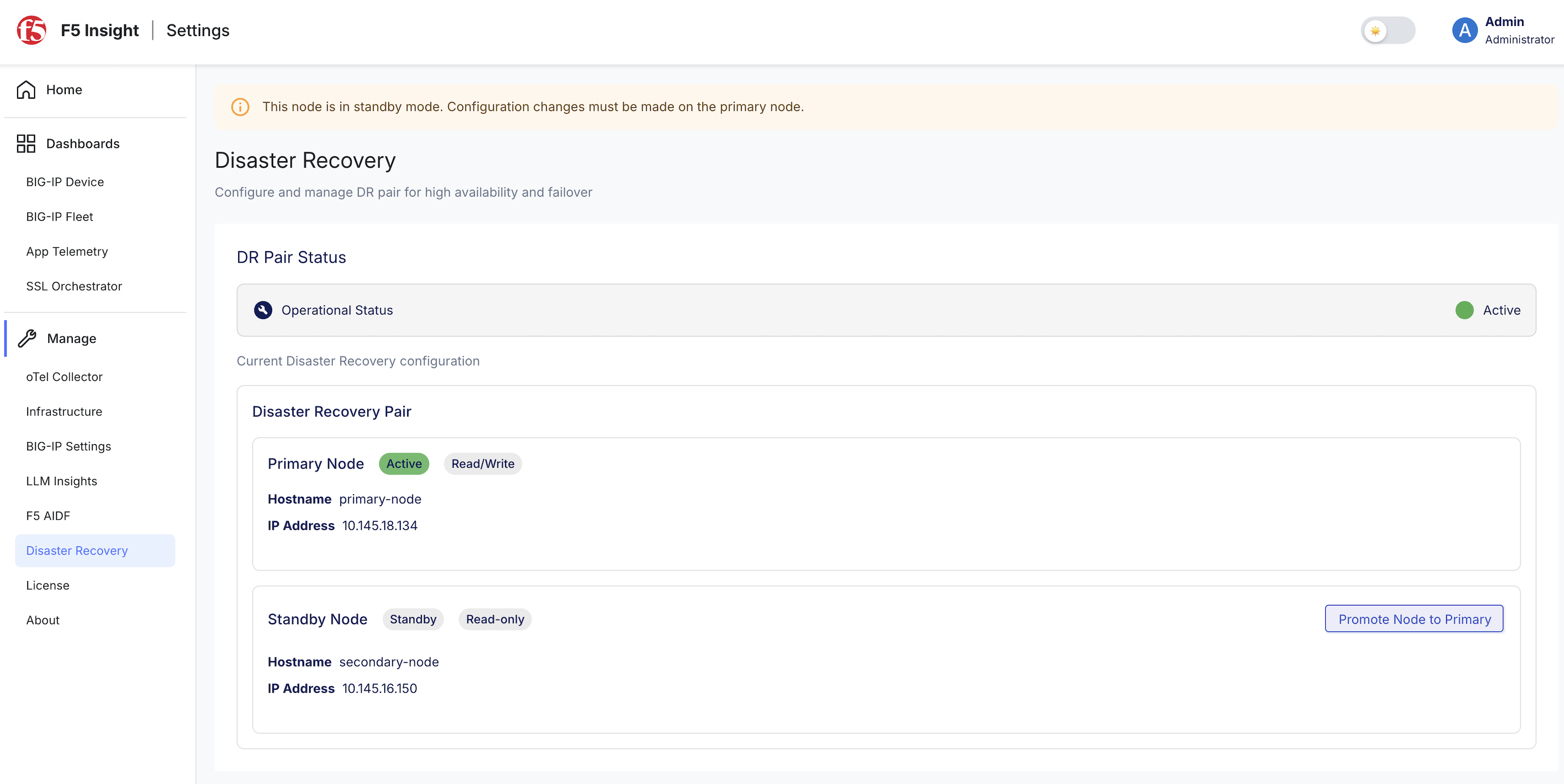

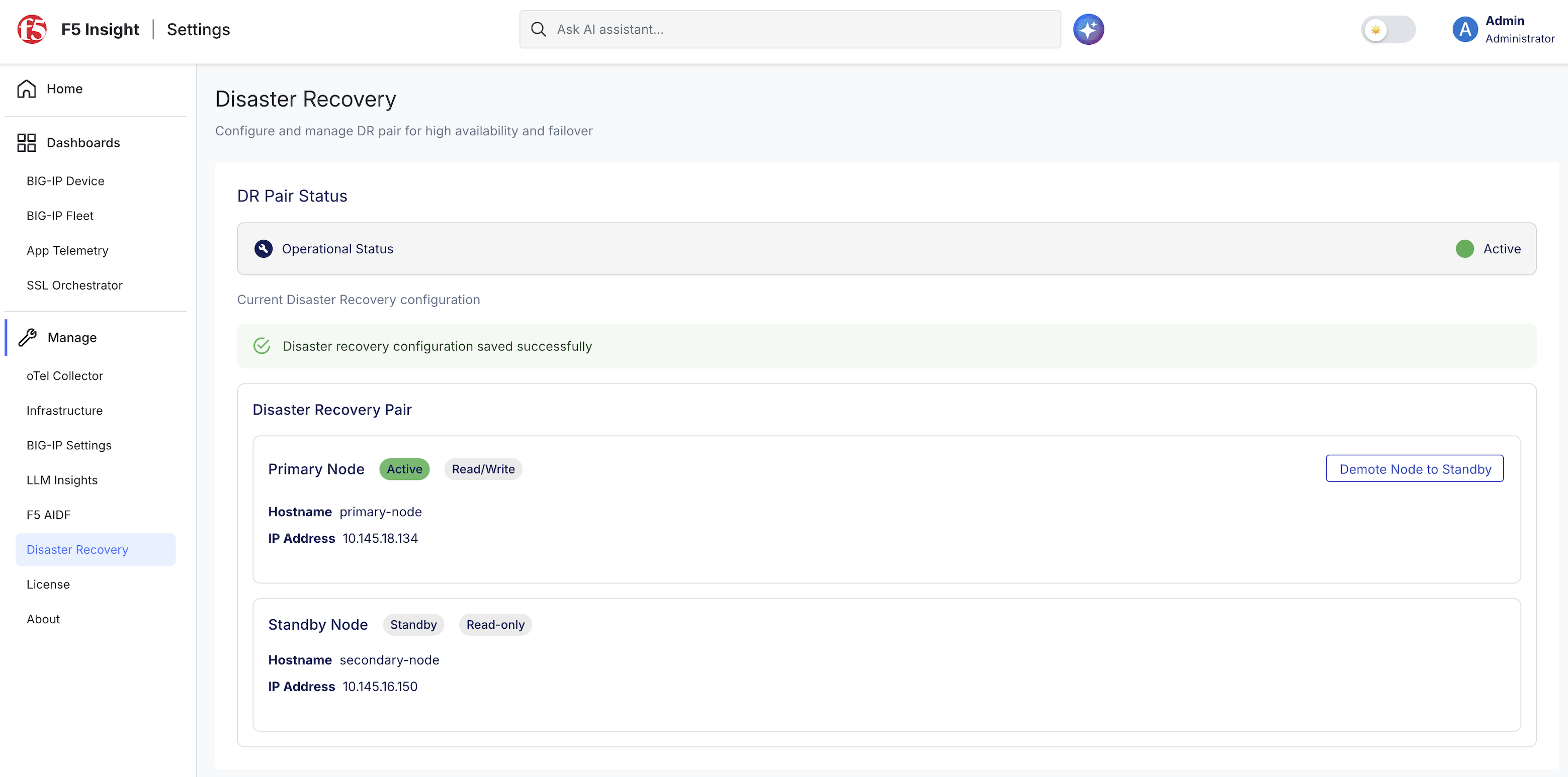

Verify DR configuration
Go back to the DR settings page:
  • Primary node — Should show “Active” and “Read/Write.”
  • Standby node — Should show “Standby” and “Read-only.”
  • DR pair status — Shows “Active” with a green indicator.

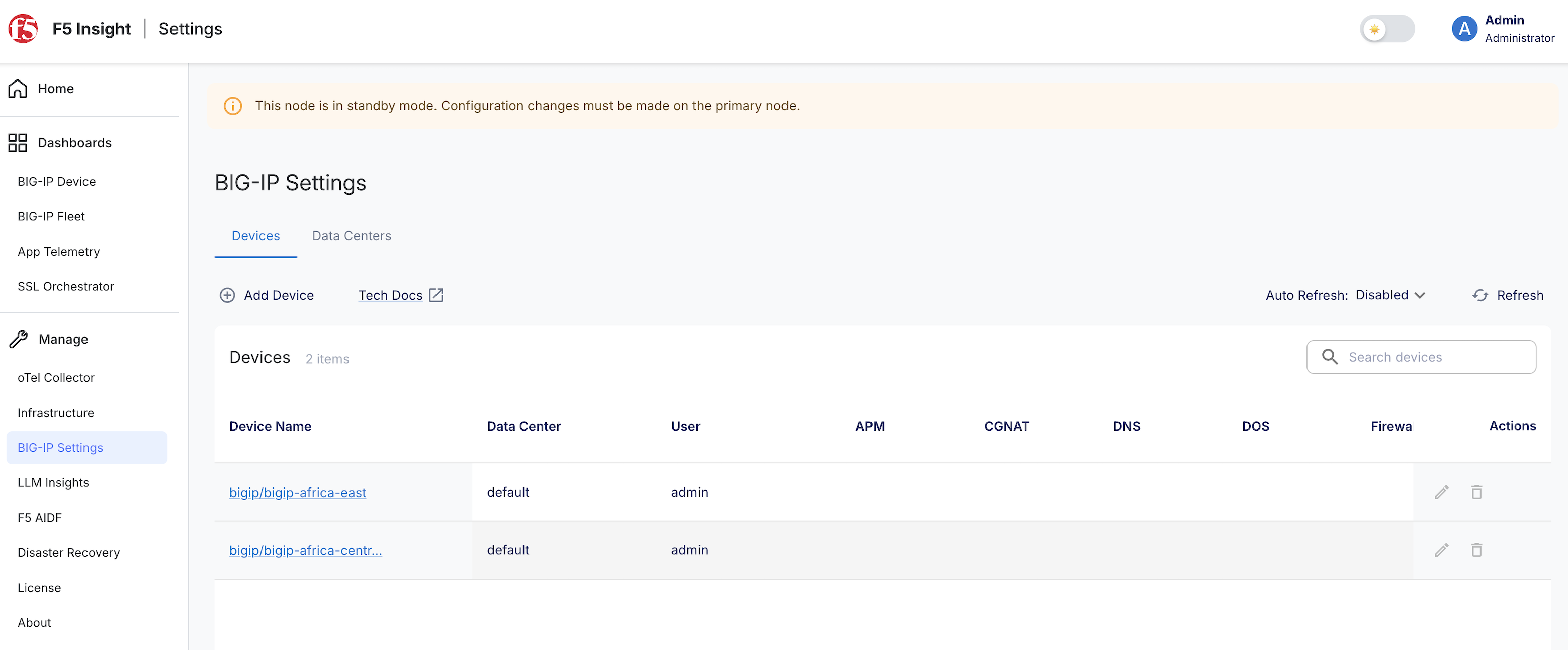

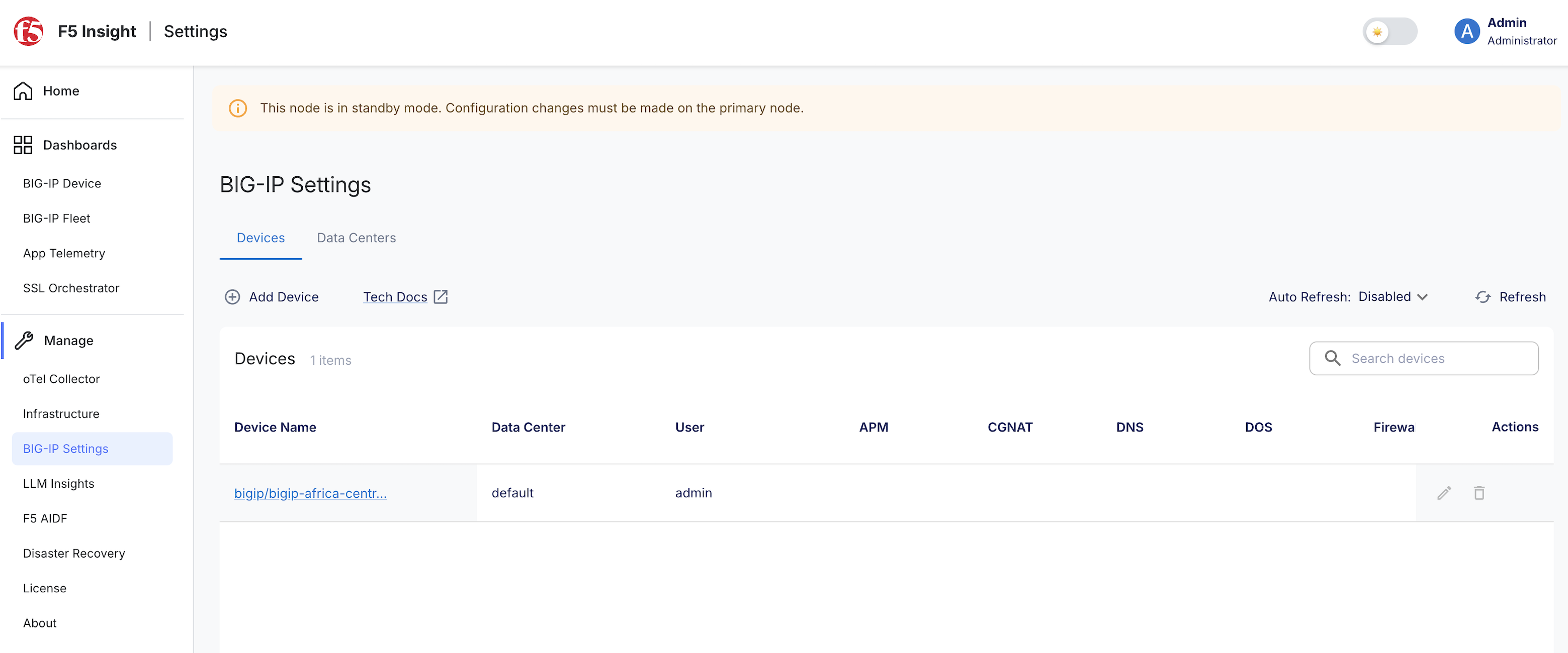

To verify standby configuration, open a browser and go to your standby instance IP address. The standby mode banner should be visible on all settings pages: “This node is in standby mode. Configuration changes must be made on the primary node.”
Standby mode

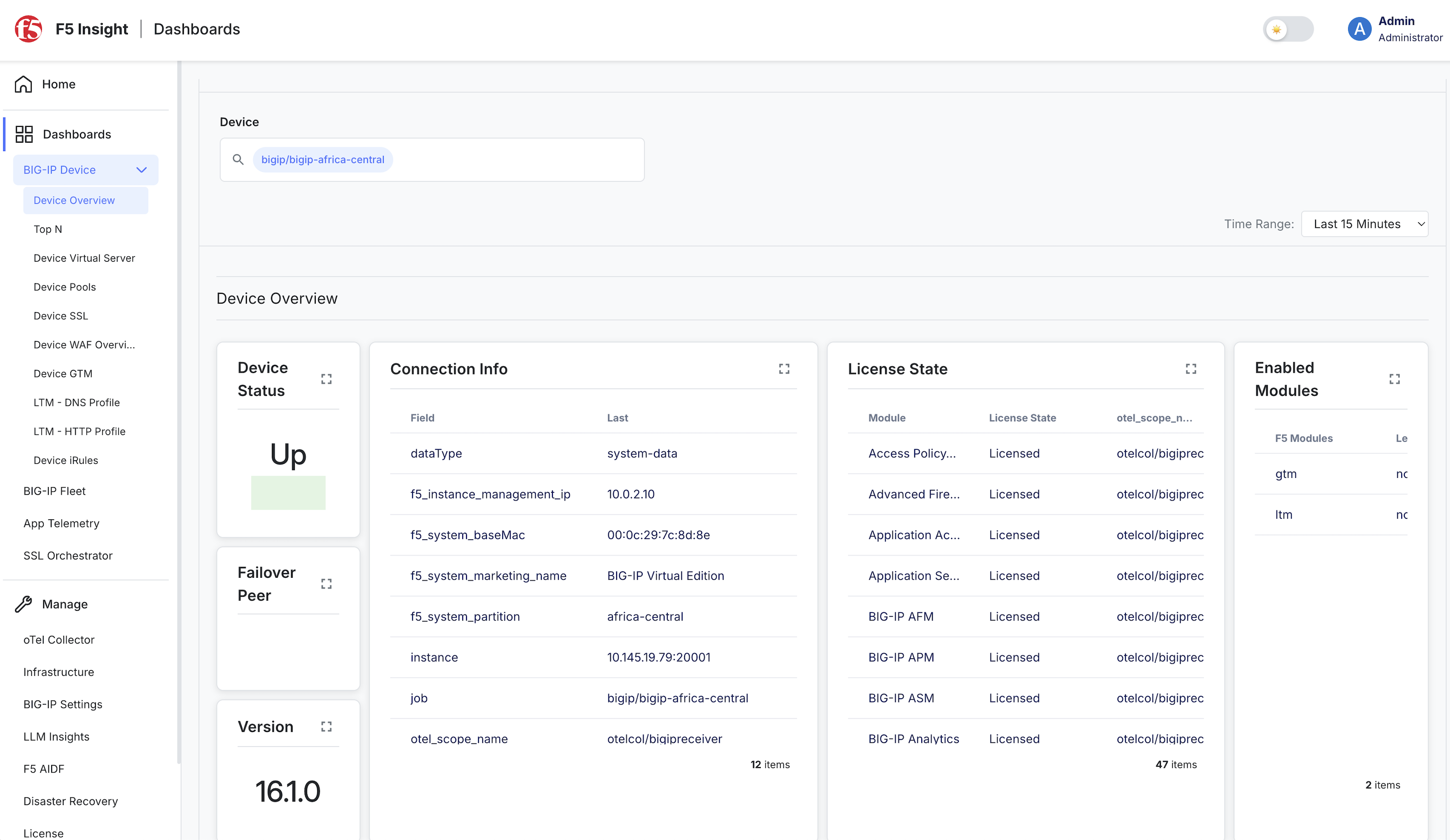

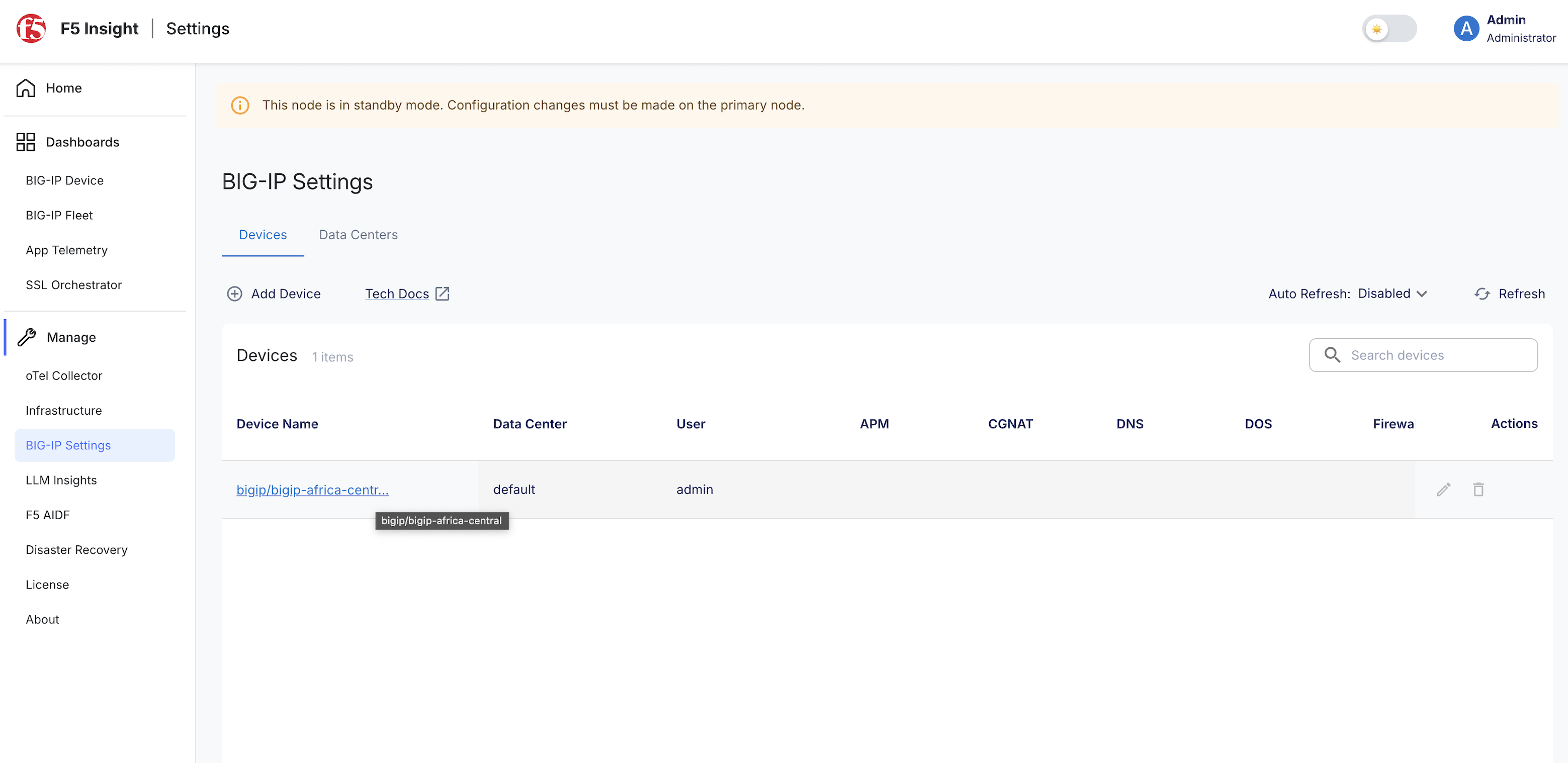

Verify data synchronization

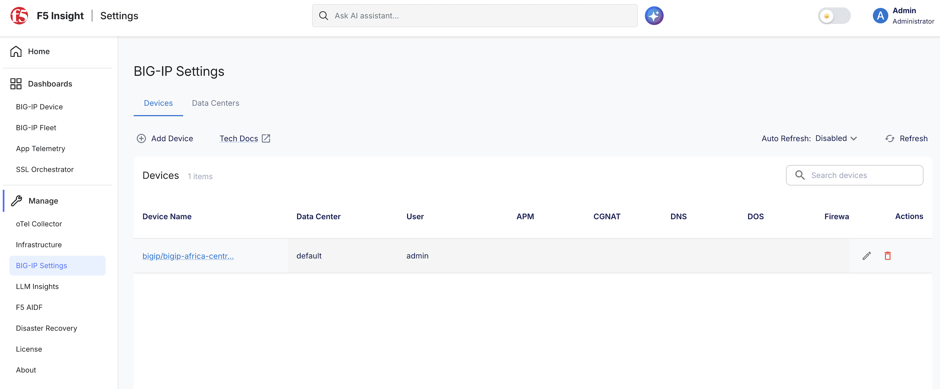

To verify data replication, make a configuration change on the primary instance, such as adding a device or modifying a setting. Then access the standby UI and refresh the page to verify the change has been synchronized.
For example, a BIG-IP device named bigip/bigip-africa-central is added to the primary.
Verify data synchronization Verify data synchronization

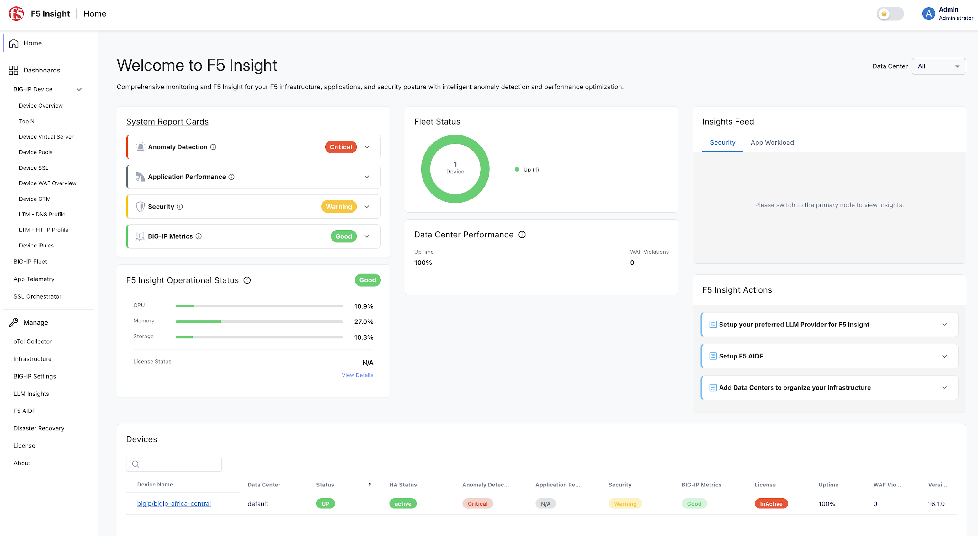

All the dashboards and Homepage on secondary should start showing data for this device.
Homepage screen Homepage dashboard

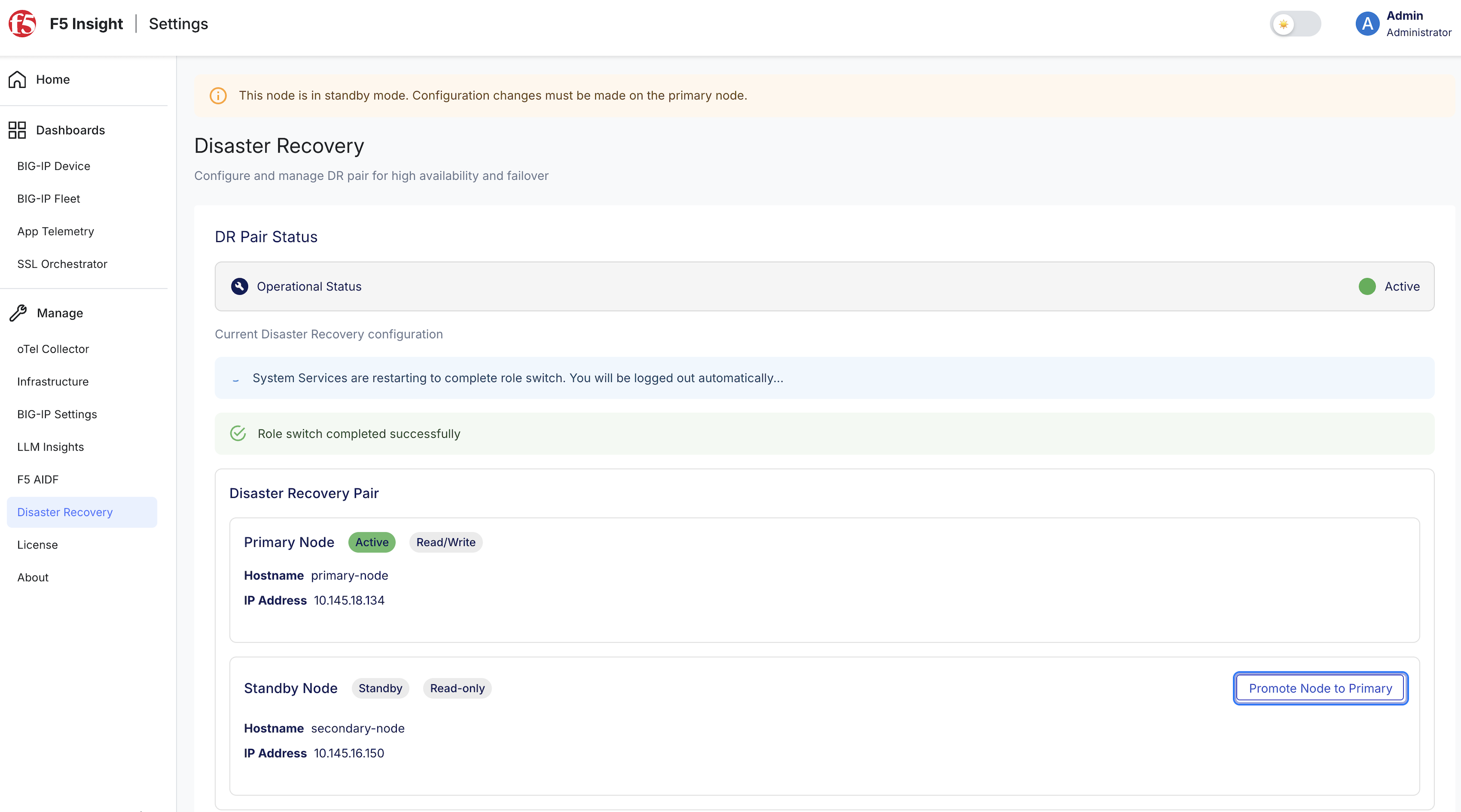

Failover (promote standby to primary)
If the primary instance fails or needs maintenance, promote the standby to act as the primary.
  1. Scale down 0 on the primary. Run the following command to scale OTEL to 0:
    sudo kubectl scale deployment otel-collector --replicas=0 -n f5-insight
    When the primary instance fails or requires maintenance, promote the standby instance to assume the primary role.

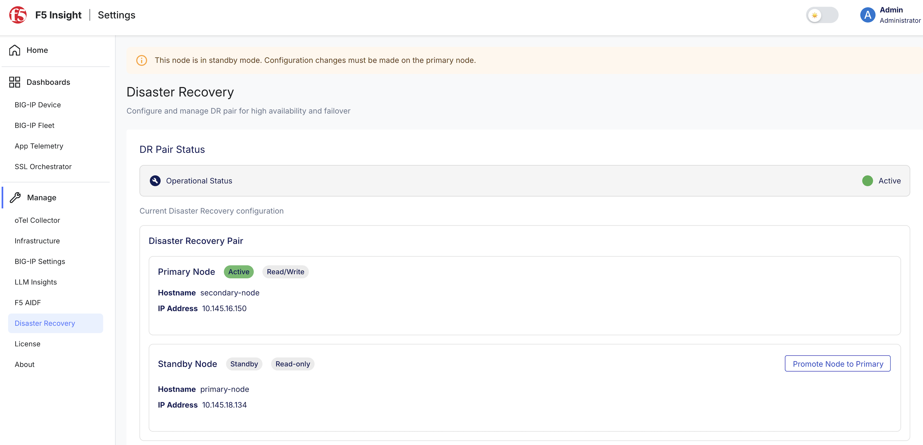

  2. Access the standby instance (https://<standby-ip>).
    Disaster recovery Disaster recovery confirmation message

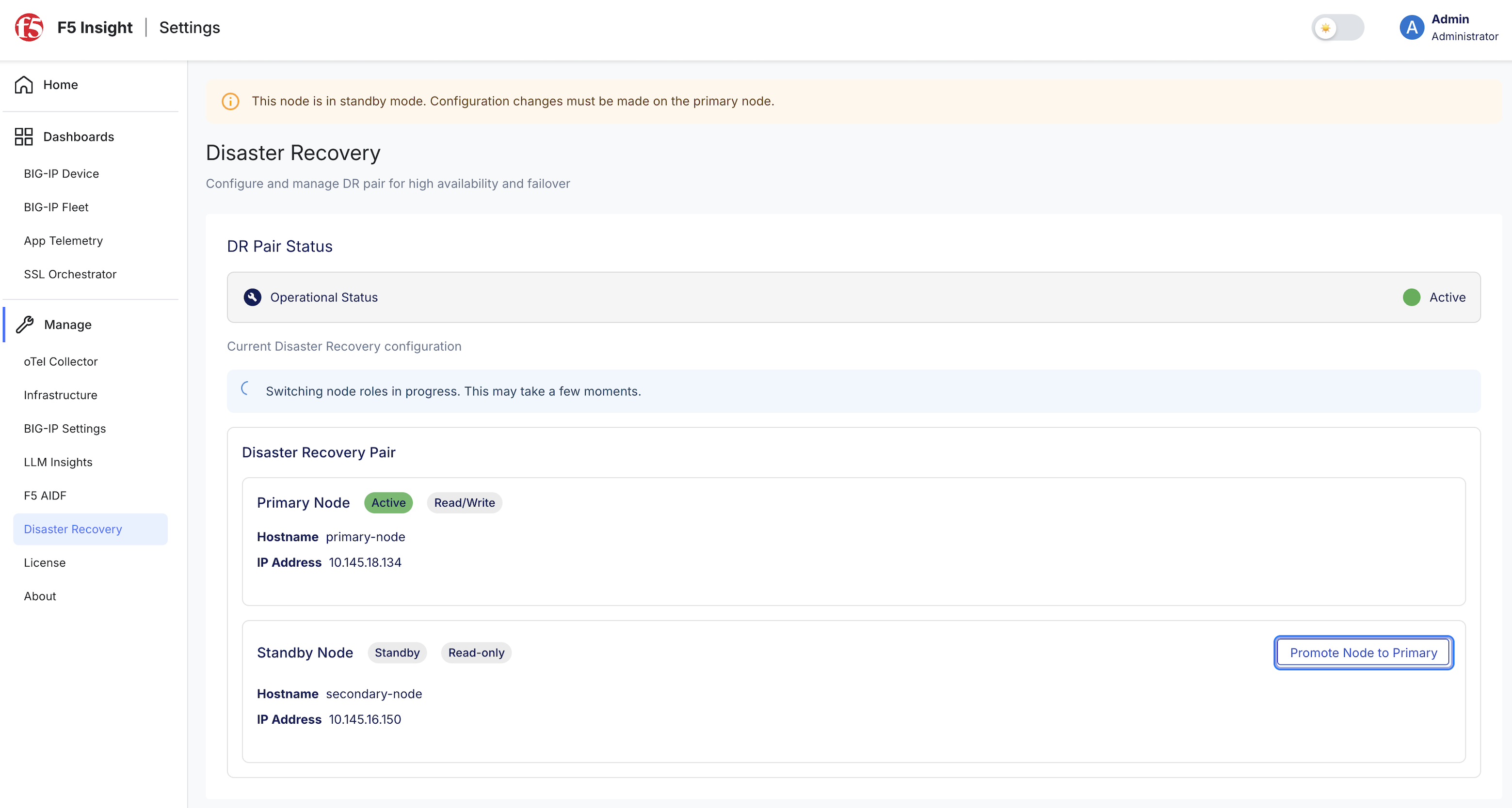

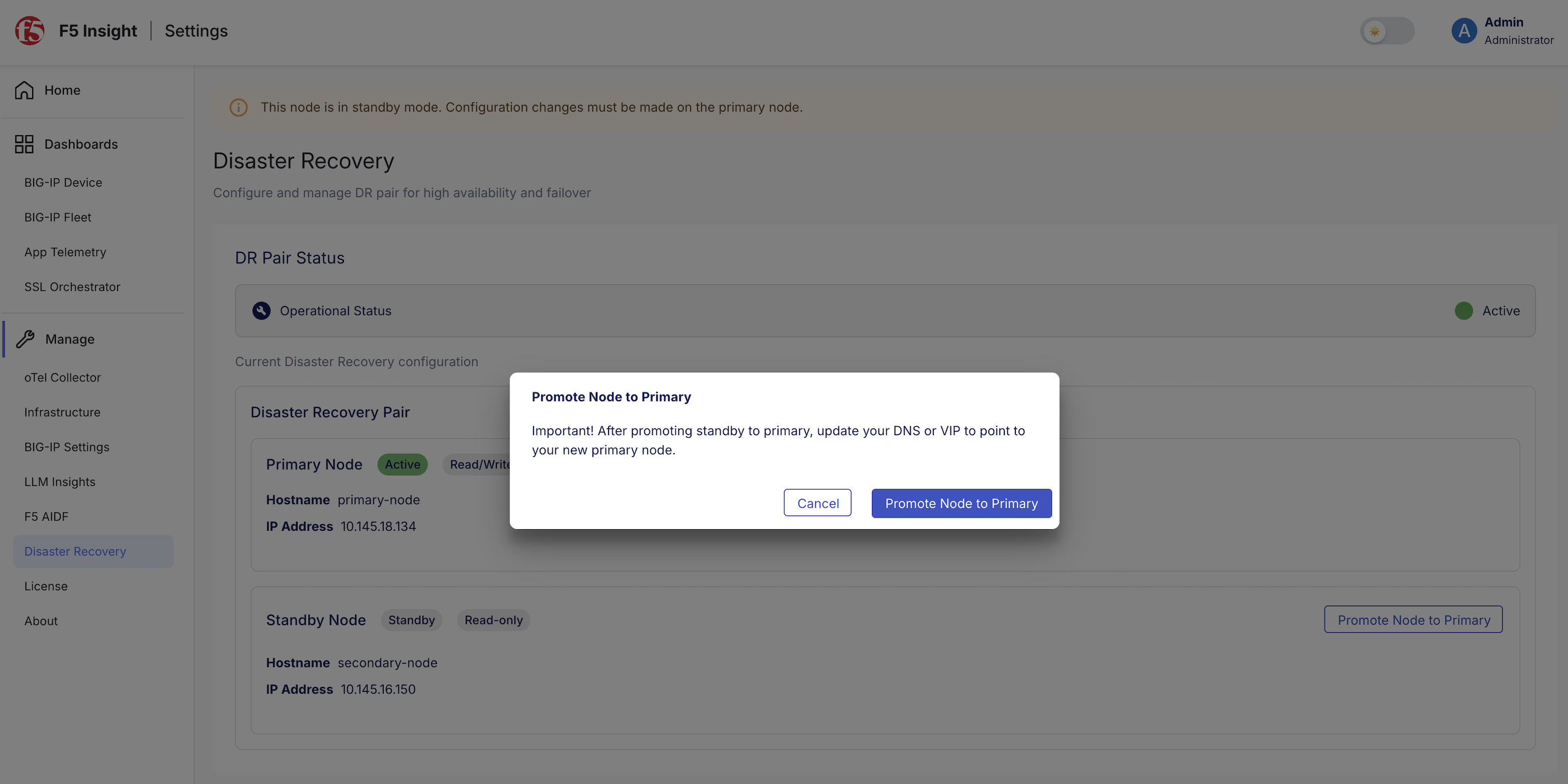

  3. Go to Settings > Disaster Recovery.
  4. Select Promote Node to Primary on the Standby Node card.
    A confirmation message displays: “Switching node roles in progress.”
    Promote node to primary Switch role complete
  5. Log back in to the new primary instance and verify the status.
Post-promotion steps:
  • Update BIG-IP log configurations to redirect logs to the new primary.
  • You can now make changes on the new primary instance.

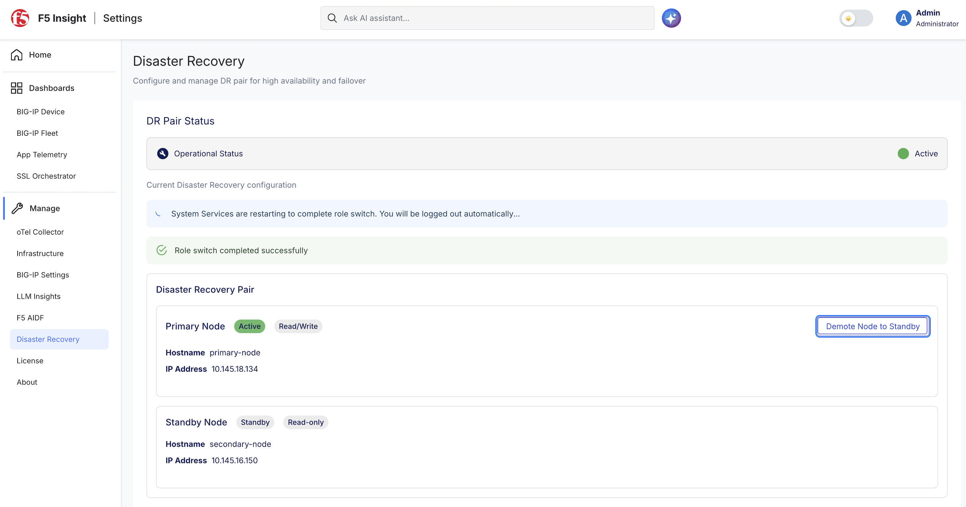

Failback (restore the original primary)
After fixing the original primary instance:
  1. Access the original primary (https://<primary-ip>).

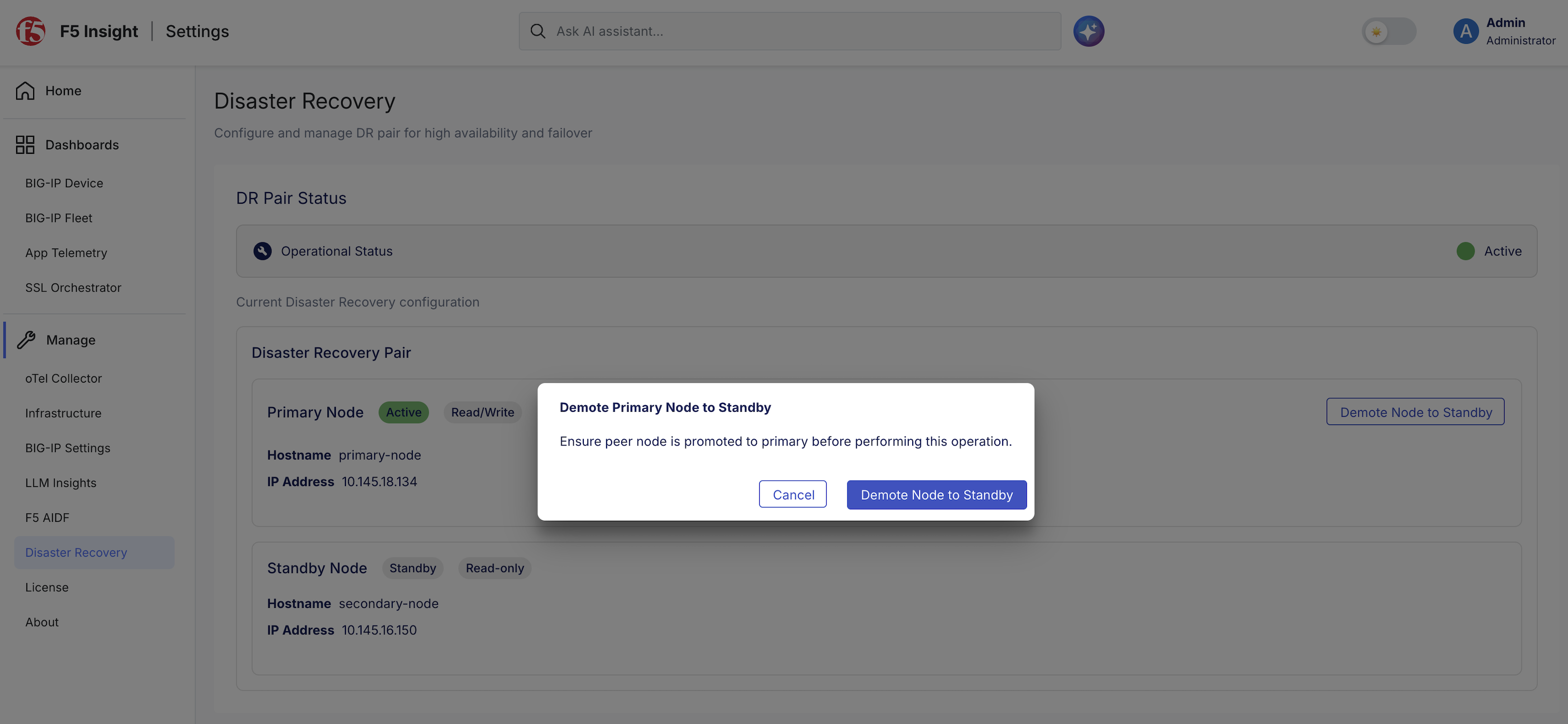

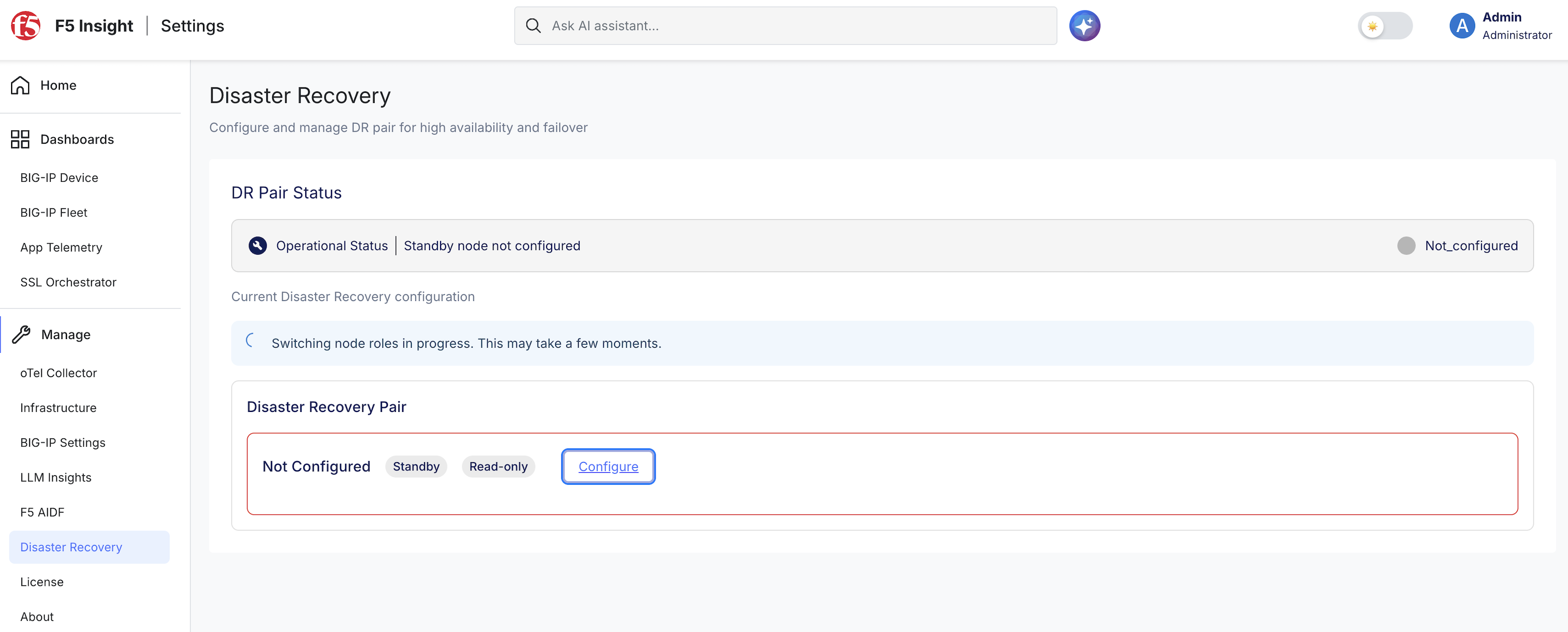

  3. Select Demote Node to Standby on the Primary Node card.
    • A confirmation dialog appears:
    Demote node to standby Demote node to standby complete
  4. Log back in to verify the system returns to standby mode. Confirm the standby mode banner is visible.
    Disaster recovery pair status BIG-IP settings
