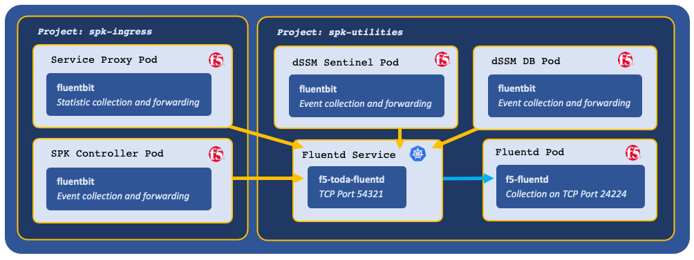

Fluentd Service
After installing Fluentd, a Service object is created to receive logging data on TCP service port 54321, and forward the data to Fluentd on TCP service port 24224. Ensure the Service port is available, and the cluster has CoreDNS enabled. In this example, the SPK components will need to resolve the f5-toda-fluentd.spk-utilities hostname:
Example Fluentd Service:
Namespace:         spk-utilities
IP:                10.109.102.215
Port:              <unset>  54321/TCP
Endpoints:         10.244.1.75:24224
Example Fluentd integration:
_images/spk-fluentd-logging.png
