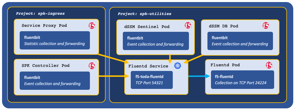

The Service Proxy for Kubernetes (SPK) Fluentd logging Pod is an open source data collector that can be configured to receive logging data from the SPK Controller, Service Proxy Traffic Management Microkernel (TMM), and Distributed Session State Managment (dSSM) Pods. To create log file directories for each of the SPK Pods, Fluentd must bind to a Kubernetes persistence volume.
This document guides you through understanding, configuring and deploying the f5-fluentd logging container.
Fluentd Service
After installing Fluentd, a Service object is created to receive logging data on TCP service port 54321, and forward the data to Fluentd on TCP service port 24224. Ensure the Service port is available, and the cluster has CoreDNS enabled. In this example, the SPK components will need to resolve the f5-toda-fluentd.spk-utilities hostname:
Example Fluentd Service:
Namespace:         spk-utilities
IP:                10.109.102.215
Port:              <unset>  54321/TCP
Endpoints:         10.244.1.75:24224
