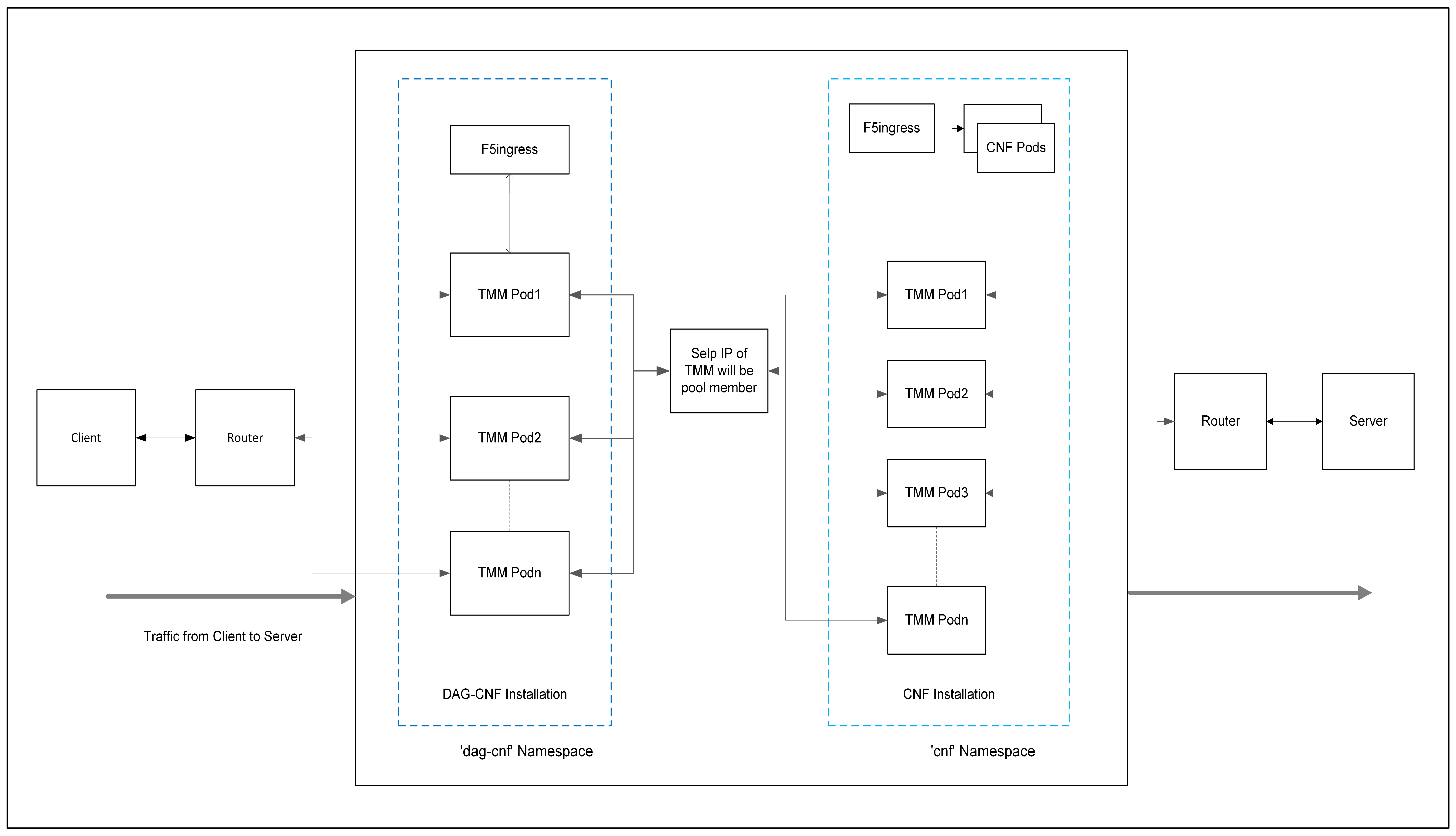

Packet flow
  • The DAG layer uses a wildcard virtual server with persistence and FastL4 profiles. The self IPs of CNF TMM Pods serve as pool members.
  • The client initiates traffic with destination as server’s IP.
  • Packets from Client should reach the TMM pod in the DAG layer, by setting a route to the TMM self IPs.
  • A TMM in the DAG layer would pick a TMM Pod in the CNF Layer, based on the hash algorithm and forward the packet without translating the destination IP.
  • The TMM Pod in the CNF Layer that receives the packet performs the regular CNF functionality such as NAT, Firewall, and forwards the packet to the server.
  • The return traffic would go back in the same path or from the CNF Layer. It can be routed to the client directly through Direct Source Routing (DSR), using routes in the CNF Layer.

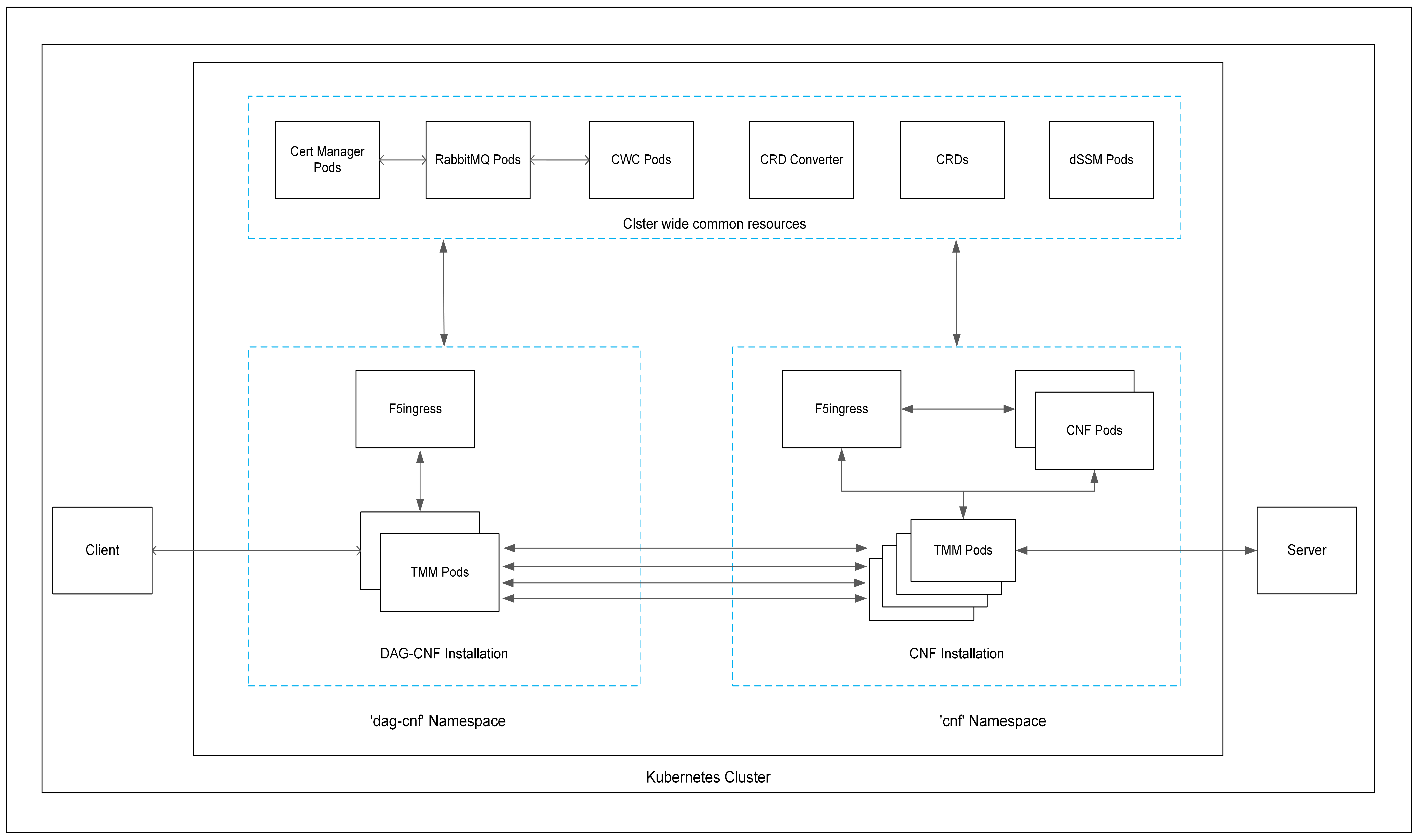

Architecture
High level design view
The following diagram depicts the high-level design architecture of DAG CNF in Kubernetes cluster.
DAG on client side
The following diagram depicts the DAG architecture on client-side traffic flow.

Intra cluster
When the DAG layer and CNF layer are present in the same cluster it is an Intra cluster architecture.
To install the DAG layer in Intra cluster architecture, CRDs and f5ingress helm charts alone are required to install the f5ingress and TMM pods. However, installing F5ingress and TMM pods alone works only if the required common components are present in any namespace. For example, if the user has three namespaces as cnf, dag-cnf, and default, the common components can be installed in any of the cnf or default namespaces.
Following is the procedure to install the f5ingress and TMM pods.

DAG-CNF Configuration
  • (Optional) Create namespace for DAG layer and CNF layer
Note: This step is required only if the DAG and CNF layers exist on the same cluster.
The DAG layer and CNF layer should exist in different namespaces for the same Kubernetes cluster.
In the architecture diagrams provided in Architecture section, the DAG layer resides in dag-cnf namespace, and the CNF layer resides in the cnf namespace.
Following are the example commands to create the namespaces:
  • For DAG-CNF: oc create namespace dag-cnf
  • For CNF: oc create namespace cnf
