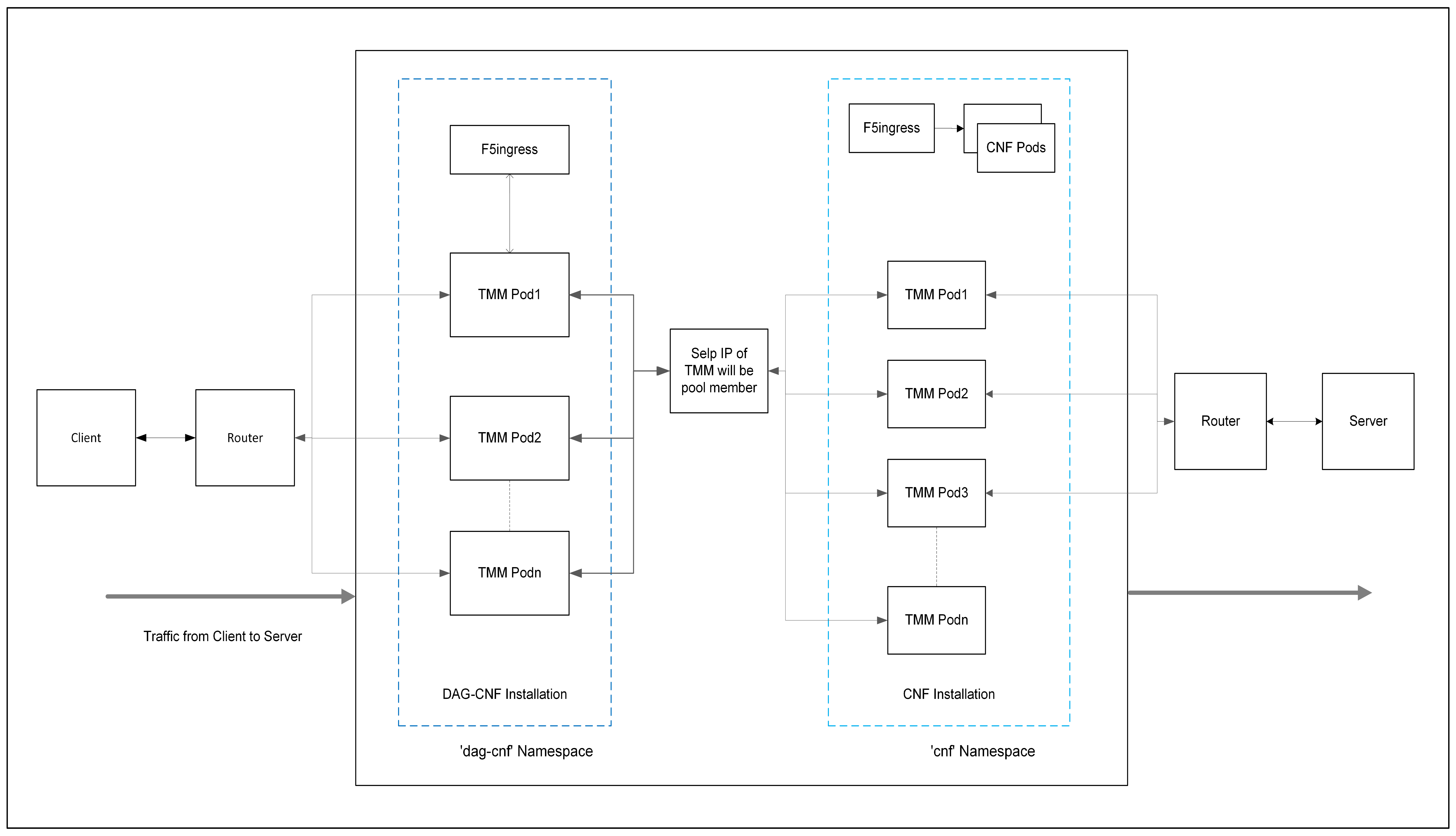

Packet flow¶
- The DAG layer uses a wildcard virtual server with persistence and FastL4 profiles. The self IPs of CNF TMM Pods serve as pool members.
- The client initiates traffic with destination as server’s IP.
- Packets from Client should reach the TMM pod in the DAG layer, by setting a route to the TMM self IPs.
- A TMM in the DAG layer would pick a TMM Pod in the CNF Layer, based on the hash algorithm and forward the packet without translating the destination IP.
- The TMM Pod in the CNF Layer that receives the packet performs the regular CNF functionality such as NAT, Firewall, and forwards the packet to the server.
- The return traffic would go back in the same path or from the CNF Layer. It can be routed to the client directly through Direct Source Routing (DSR), using routes in the CNF Layer.

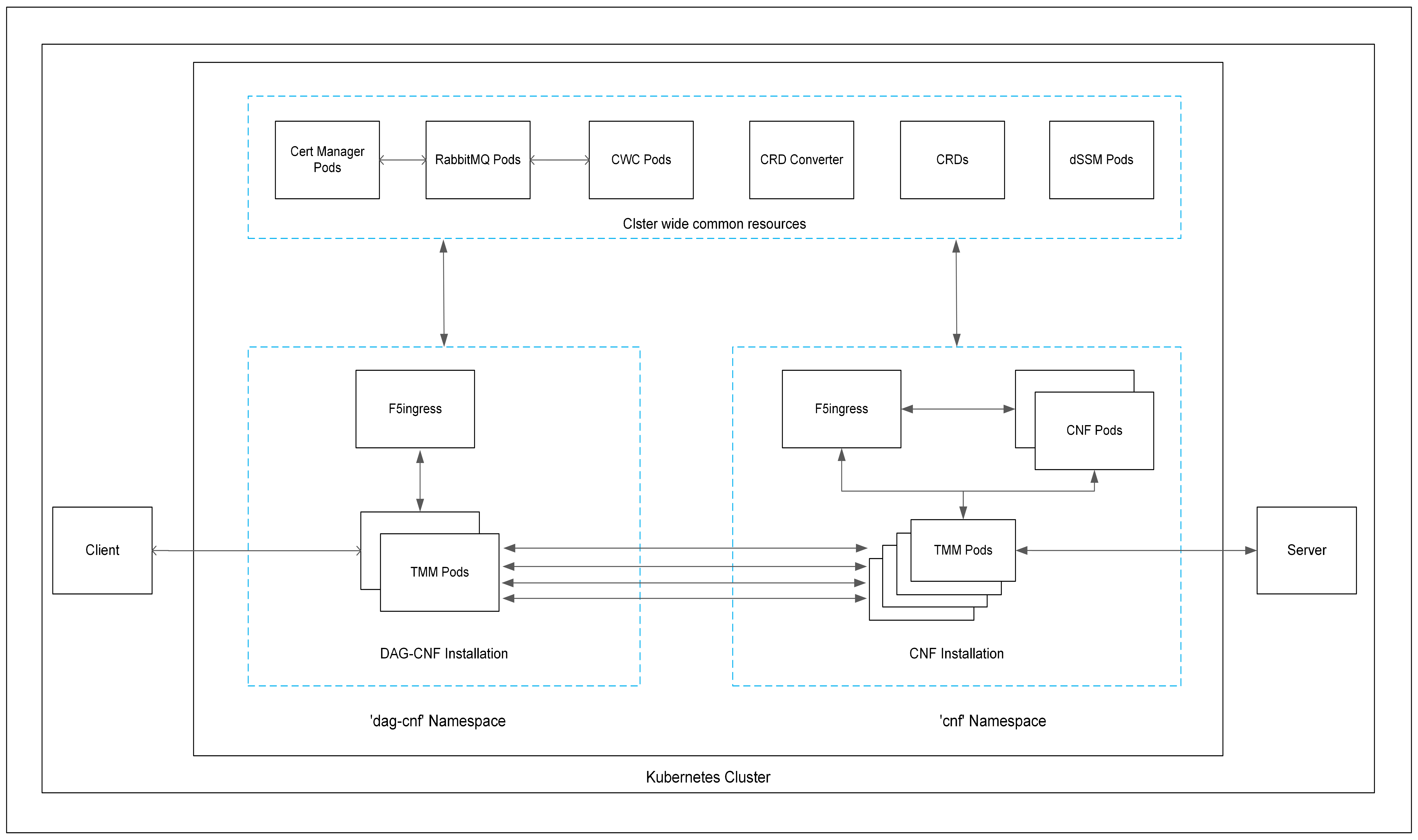

High level design view¶
The following diagram depicts the high-level design architecture of DAG CNF in Kubernetes cluster.
