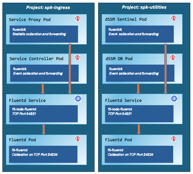

Fluentd Service
Upon installing SPK Fluentd, a Kubernetes Service object is created to receive logging data from Fluent bit on TCP service port 54321 and forward the data to Fluentd on TCP target port 24224. Ensure the service port is available, and the cluster has CoreDNS enabled. In the following example setup, Fluentd is deployed in two projects to collect logs from their respective pods.
Example Fluentd Setup:
_images/spk-fluentd-logging-latest.png
Example Fluentd Service:
Namespace:         spk-utilities
Port:              54321/TCP
Namespace:         spk-ingress
Port:              54321/TCP

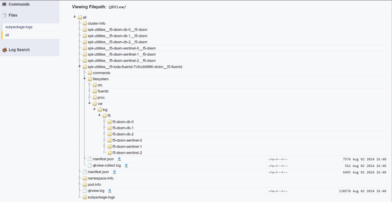

_images/spk_info.png Note:  Logs collected by Fluentd are also available as part of QKView diagnostic tarball. To include log files from all Fluentd pods, remember to run the QKView utility with their respective namespaces.
In this example, QKView utility should be invoked as follows:
./qkview-wrapper-linux -f ./qkview-collector.sh -n spk-ingress,spk-utilities
(or)
./qkview-wrapper-darwin -f ./qkview-collector.sh -n spk-ingress,spk-utilities
In the iHealth website, the log files from different pods would be visible under their respective Fluentd pod’s filesystem subtree:
_images/spk_iHealth.png
