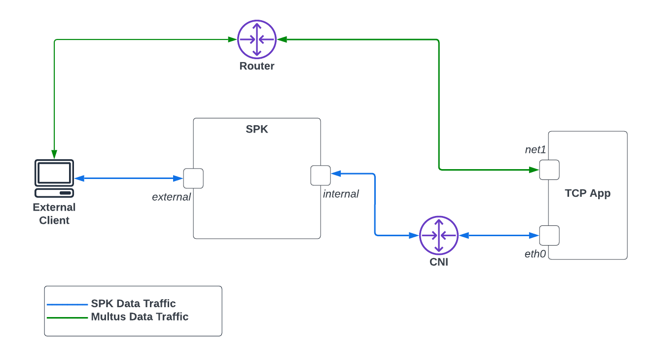

When you add an additional network interface on a pod using the Multus CNI, traffic going to and from that interface bypasses the default CNI. And for us, it also bypasses SPK. An example illustrating this is shown below.
Diagram 1: Traffic on Additional Pod Interfaces
In Diagram 1, traffic from a pod, by default, uses the default CNI for network traffic. In the example here, the default network traffic is through eth0. But when you add an additional interface, say net1, traffic will bypass the default CNI and thus SPK. And in the case here, it is connected to a router. Because of the different network route, you will not be able to apply any SPK security features on net1 by default.
This guide will walk through steps to change network traffic on the secondary interface so that it goes though SPK enabling firewall functions.
This release will route traffic from only ONE additional interface on your application through SPK.

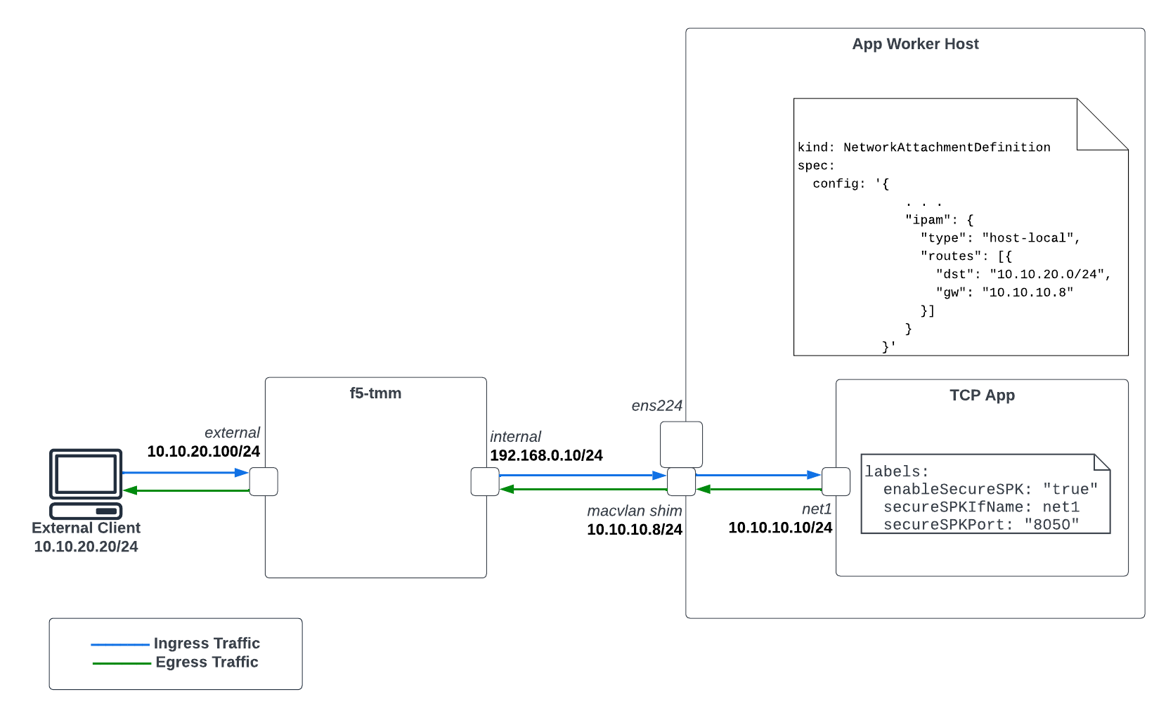

We will assume the following SPK configuration and the overall infrastructure. The network IP address examples throughout this guide will be also be based from the diagram below.
Diagram 2: SPK Firewall Infrastructure Overview Using Multus
The External Client has a static route configured such that 10.10.10.0/24 is routed to the external interface of SPK. A snippet showing this route below.
external-client $ ip route
10.10.10.0/24 via 10.10.20.100 dev ens224 proto static

Apply MacVlan Network attachment definition in Watch Namespace to assign an IP address to secondary interface of Application Pod (CNF)¶
10.10.20.0/24is the subnet configured on the external client.10.20.10.105is the configured IP address on the shim interface.
apiVersion: "k8s.cni.cncf.io/v1"
kind: NetworkAttachmentDefinition
metadata:
spec:
config: '{
"cniVersion": "0.3.1",
"type": "macvlan",
"mode": "bridge",
"master": "ens224",
"ipam": {
"type": "host-local",
"subnet": "10.20.10.0/24",
"rangeStart": "10.20.10.170",
"rangeEnd": "10.20.10.180"
