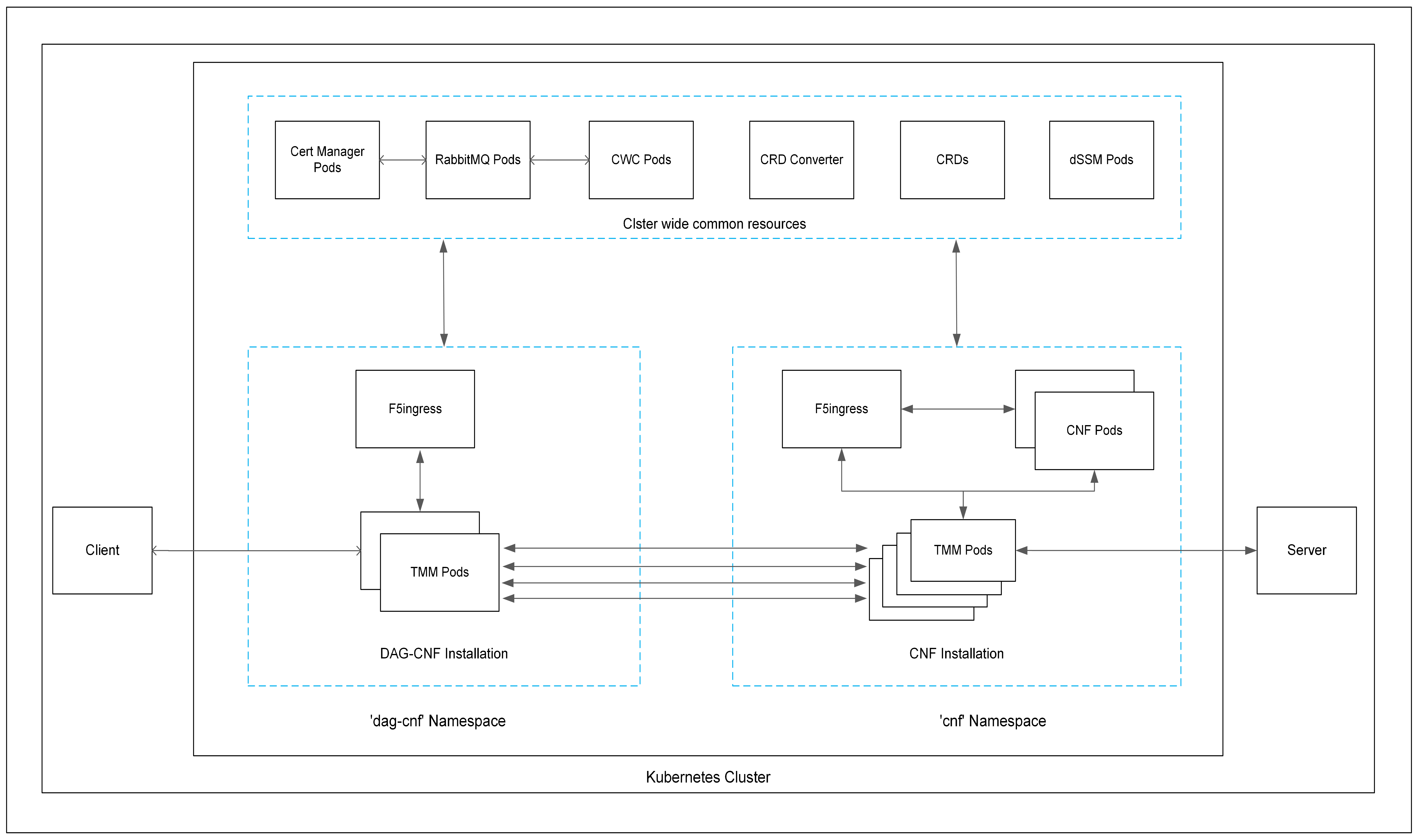

Architecture
High level design view
The following diagram depicts the high-level design architecture of DAG CNF in Kubernetes cluster.

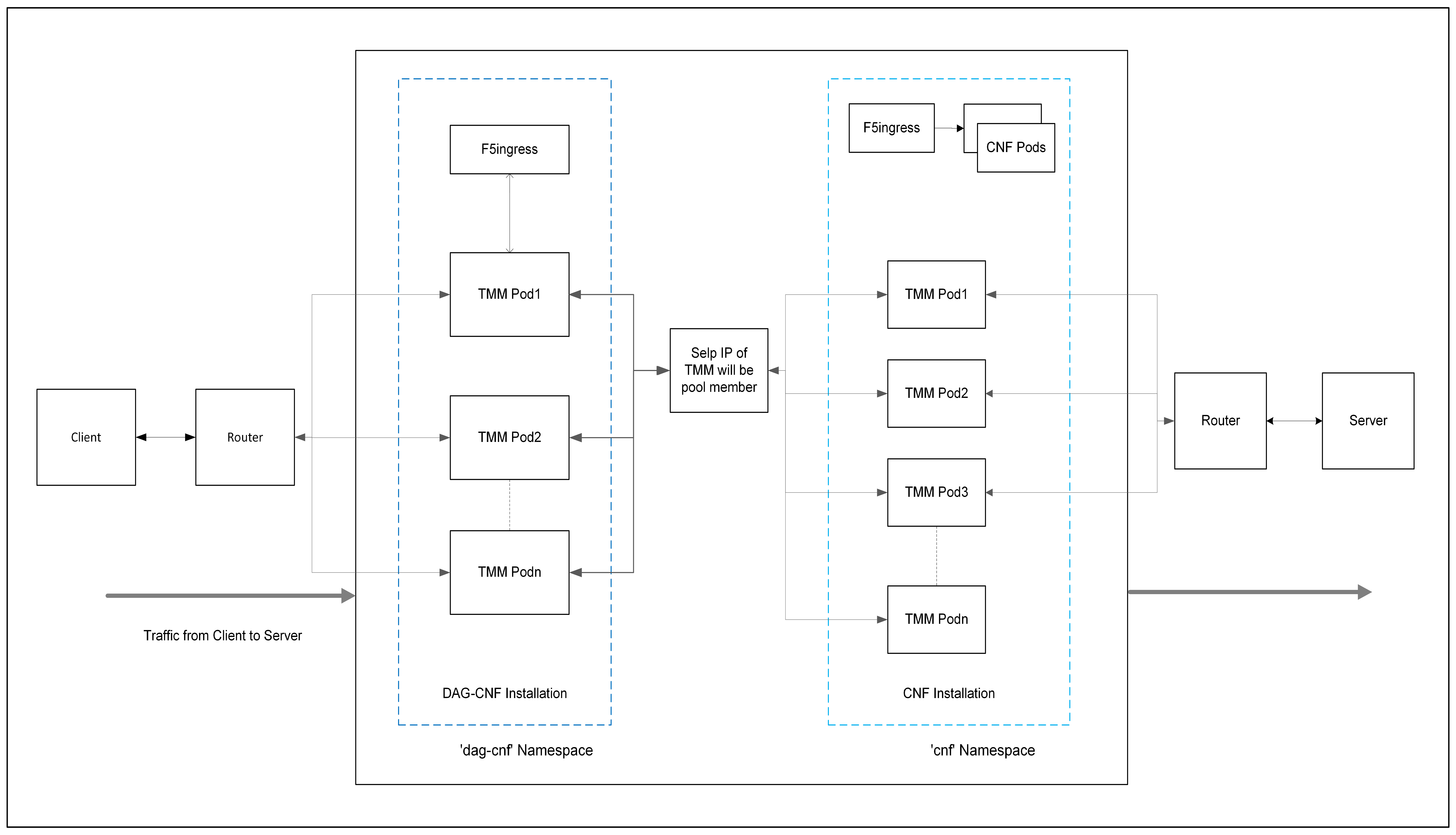

DAG on client side
The following diagram depicts the DAG architecture on client-side traffic flow.
