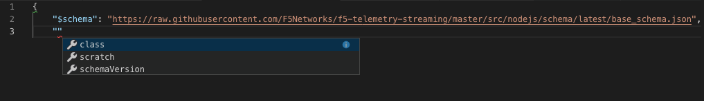

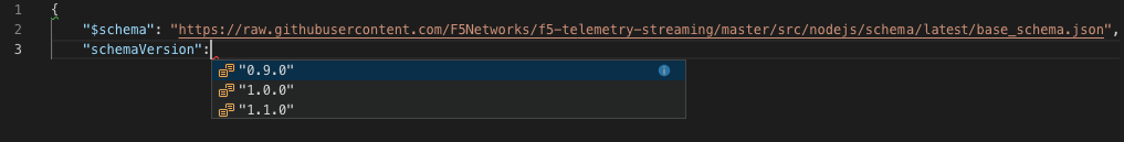

- As you begin to type the properties of your declaration, the validation process suggests valid options.
- It also suggests valid options for a property in the declaration:

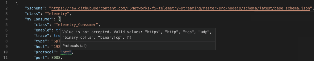

- You can also hover on a red wavy line (for JSON syntax errors), or a green wavy line (schema validation errors) to see the problem. In the following example, the end of the line has both red and green wavy lines, so both errors display.

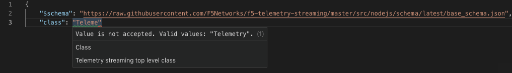

- In this example, the validator discovers a typo of the word Tenant.

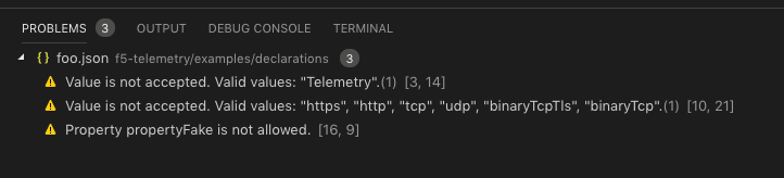

- For a full declaration, it is often easier to view the Problems (View > Problems). In this example, the validator discovers a number of issues. You can click individual problems to go directly to the line with the issue.
