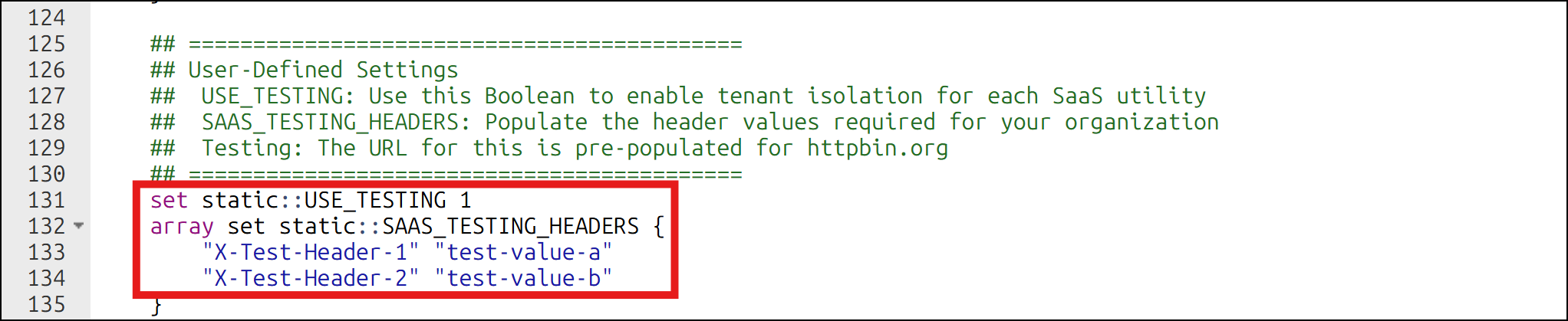

  2. Please focus on lines 125-135 of the iRule. This is where we will test the proper insertion of headers for this lab. This section sets the static variable and array to define what headers and values are to be inserted.
    ../../_images/saas-irule-lab-test.png

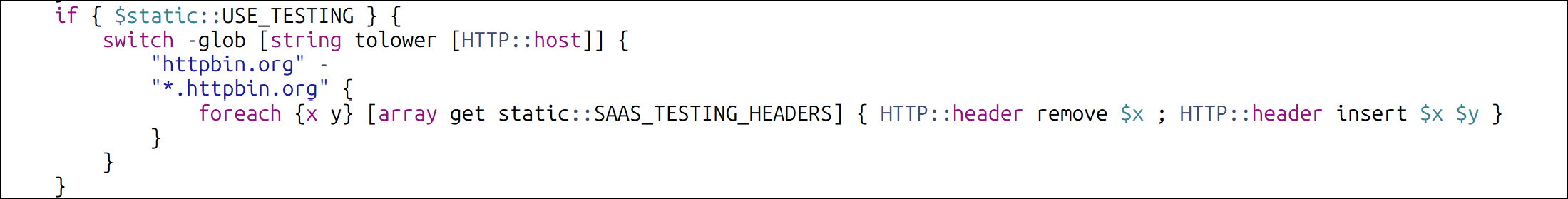

  3. Now go to lines 241-248. This section executes the action based on the match of the URL. In this case, we are matching against httpbin.org. This is so we can actually see the headers being inserted.
    ../../_images/saas-irule-action.png

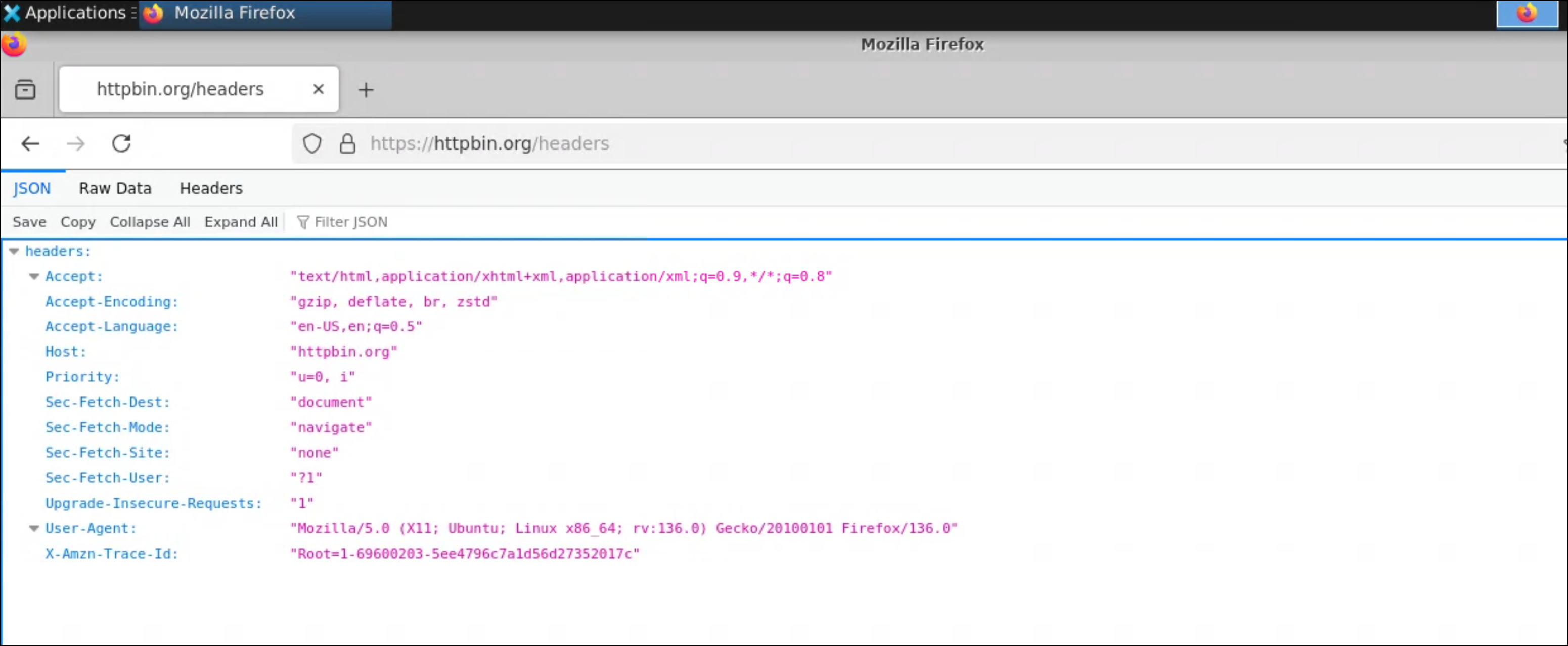

  3. Navigate to the following URL:
    https://httpbin.org/headers
  4. You should not see the X-Test-Header-1 or X-Test-Header-2 headers in the response. You will see something similar the following:
    ../../_images/saas-headers-missing.png

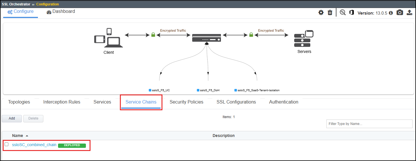

  1. Click on the Service Chains tab and click the existing Service Chain ssloSC_combined_chain.
    ../../_images/saas-service-chain.png

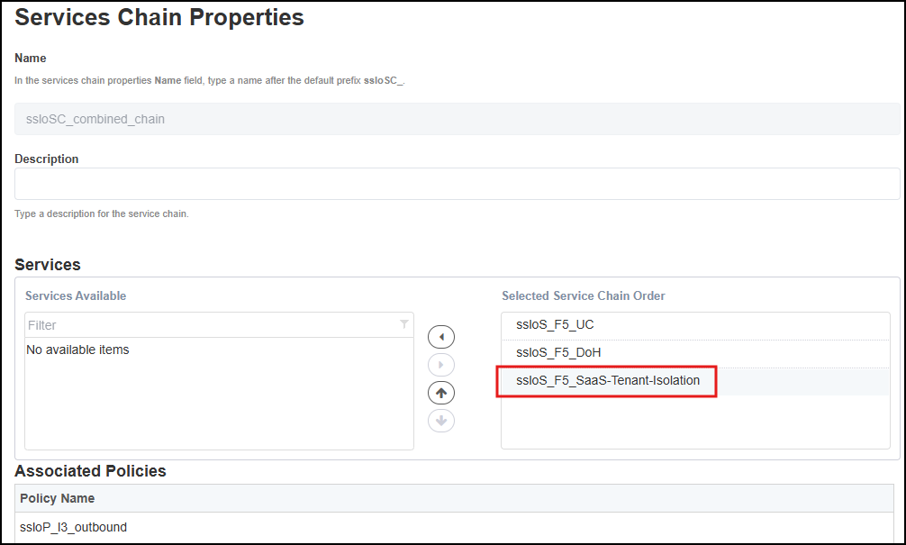

  2. The name field is already filled out as we are amending the existing Service Chain.
  3. Double-click on the ssloS_F5_SaaS-Tenant-Isolation Service to add to the Selected Service Chain Order.
    ../../_images/saas-service-chain-add.png
  4. Click Deploy and then OK to acknowledge the warning. Click OK again after the deployment has completed.

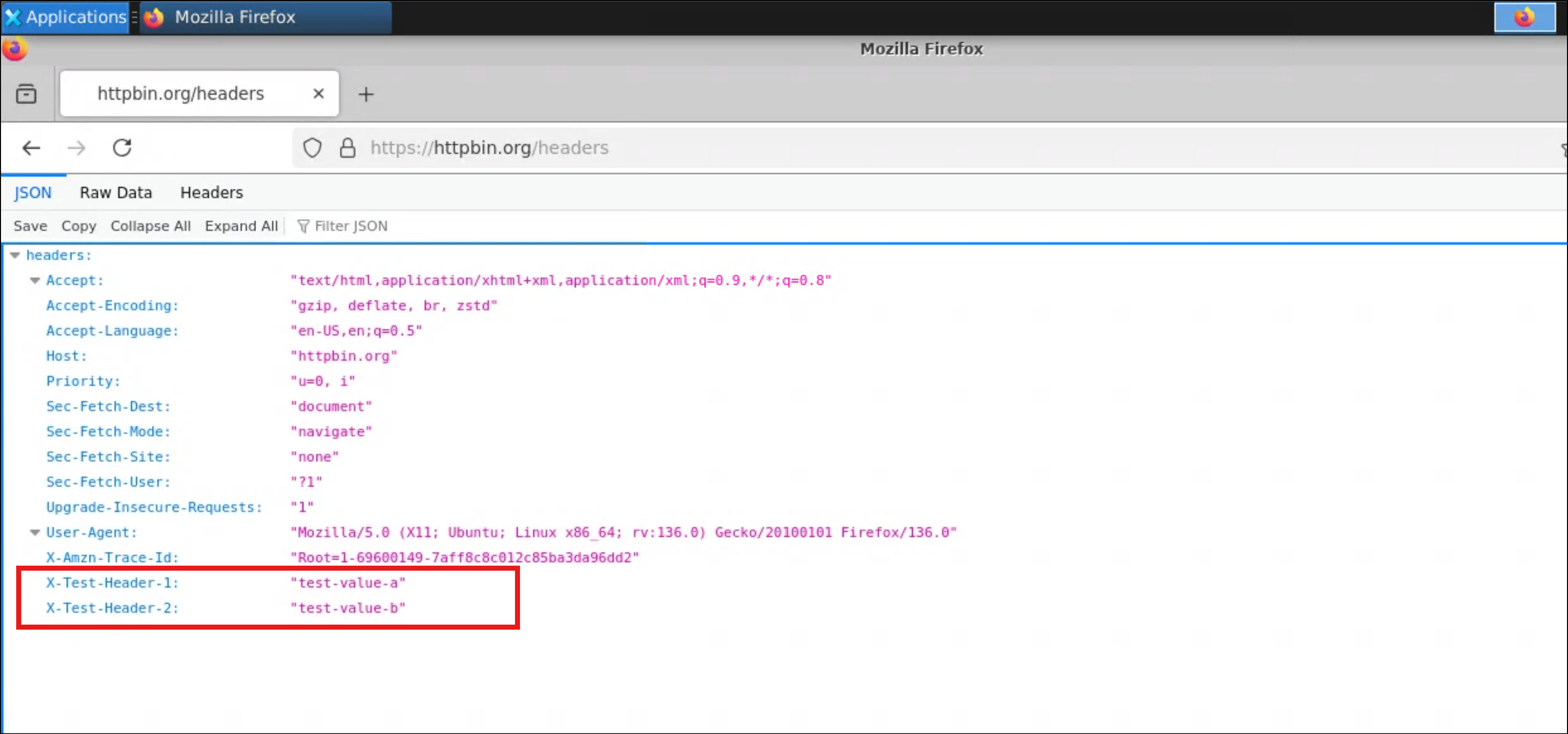

  4. Now you will see both the X-Test-Header-1 or X-Test-Header-2 headers in the response.
    ../../_images/saas-headers-inserted.png
