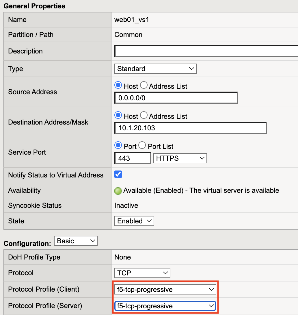

  1. Go the the UI of BIGIP01 and change the TCP profiles of web01_vs1 to F5-tcp-progressive and click the Update button at the bottom of the page to save changes.
    ../../_images/tcp_progressive.png

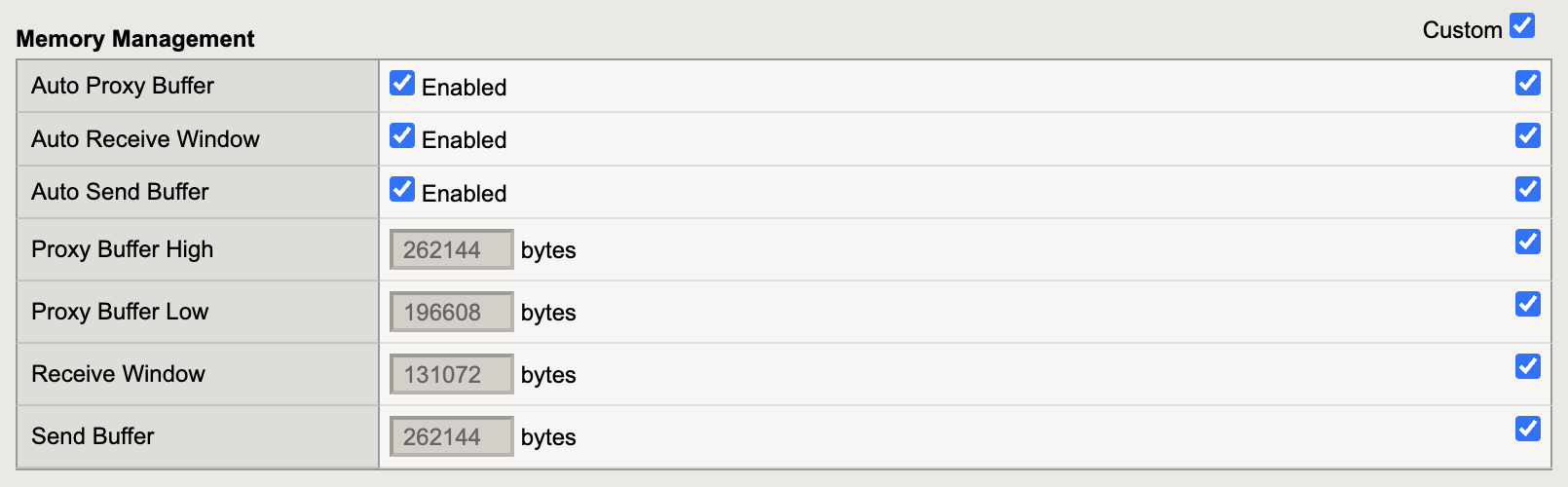

    The main difference with f5-tcp-progessive is Auto Proxy Buffer is enabled in the Memory Management section. Auto Proxy Buffer adjusts the TCP buffers settings based on performance of the conenctions.
    ../../_images/tcp_progressive_buffers.png

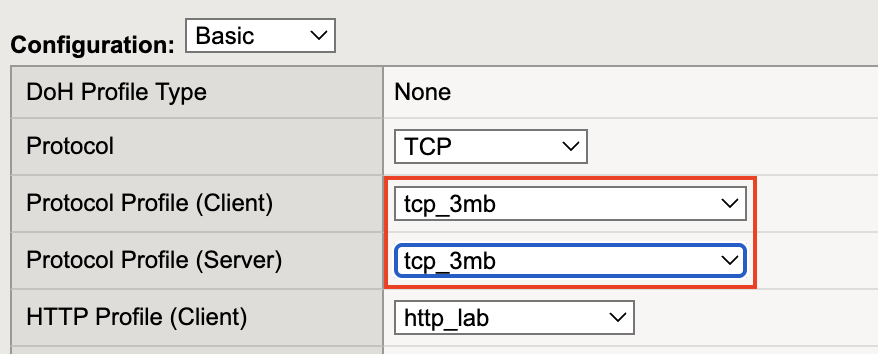

  1. Go back to the BIGIP01 UI and change Virtual Server web01_vs1 to use a custom TCP profile configured for the lab with 3MB buffers (tcp_3mb) and click the Update button at the bottom of the page to save the change.
    Higher buffers will use more memory for each TCP connection while f5-tcp-progressive may use more CPU as it calculates the buffer sizes. Any of these changes should be tested before being applied in a production environment.
    ../../_images/tcp_3mb.png

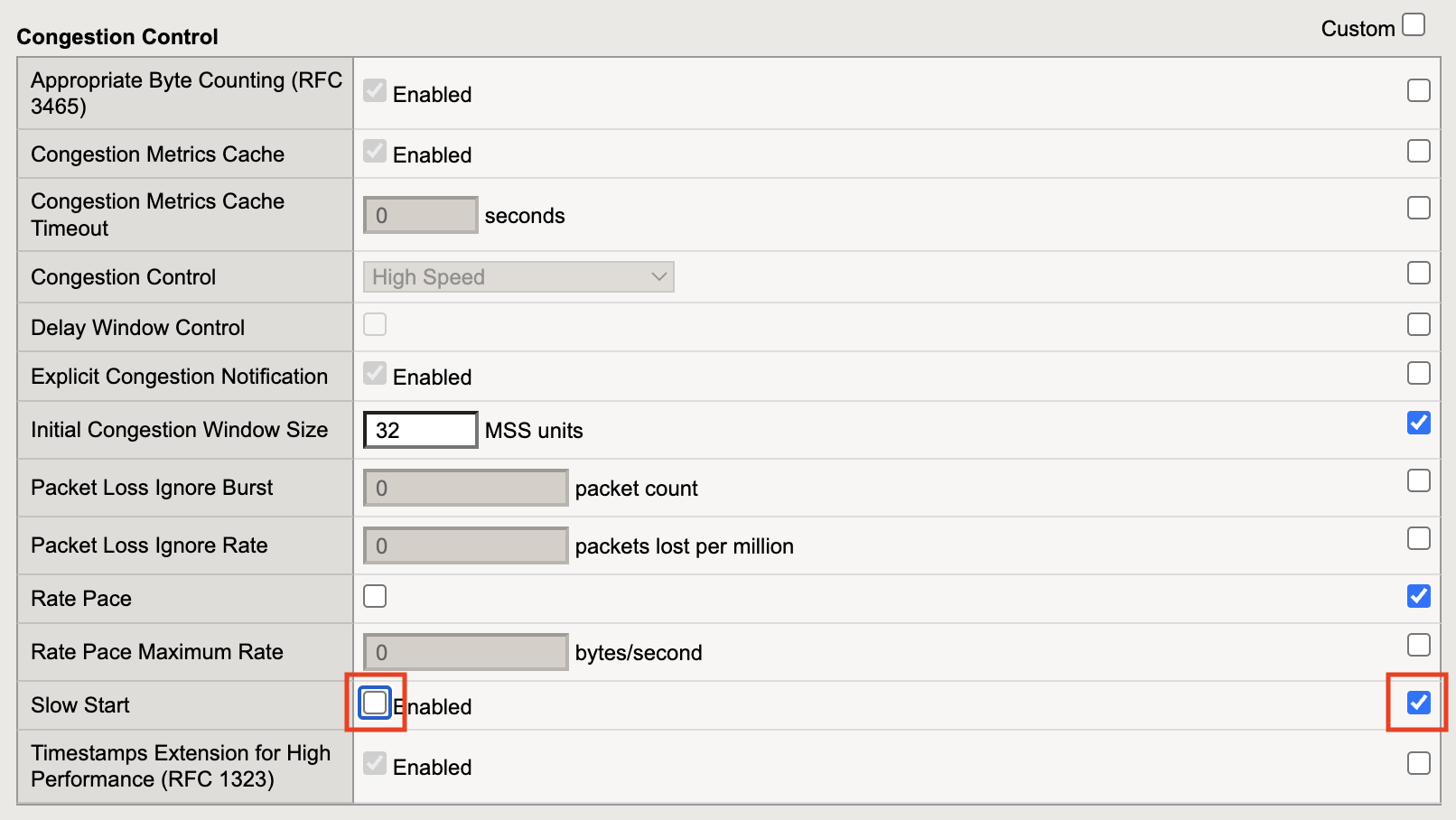

Disable TCP Slow Start
  1. From BIGIP01 UI, go to Local Traffic > Profiles > Protocols > TCP and click on tcp_3mb from the list
  2. Scroll down to the Congestion Control section
  3. Click the check box to the far right of Slow Start to enable editing of the Slow Start property
  4. Clear the Enabled check box for Slow Start
    ../../_images/tcp_3mb_cong_control.png
  5. Click the Update button at the bottom of the page to save the setting

    The total time should be around 8 seconds after disabling Slow Start. The biggest improvement in the lab is on the client side. The server-side is able to react quicker to TCP Window changes with the low latency. The client-side is now able to ramp up faster with Slow Start disabled. Slow Start is there to prevent TCP connections from overloading available network bandwidth. If you see congestion and packet retransmissions within an environment you should leave Slow Start enabled. With the flxibility of TMOS, Slow Start can be enabled/disabled on either server or client sides of the connection independently.
