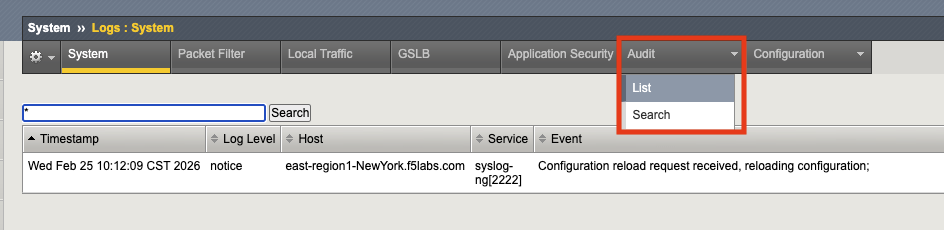

  2. Navigate to System -> Logs.

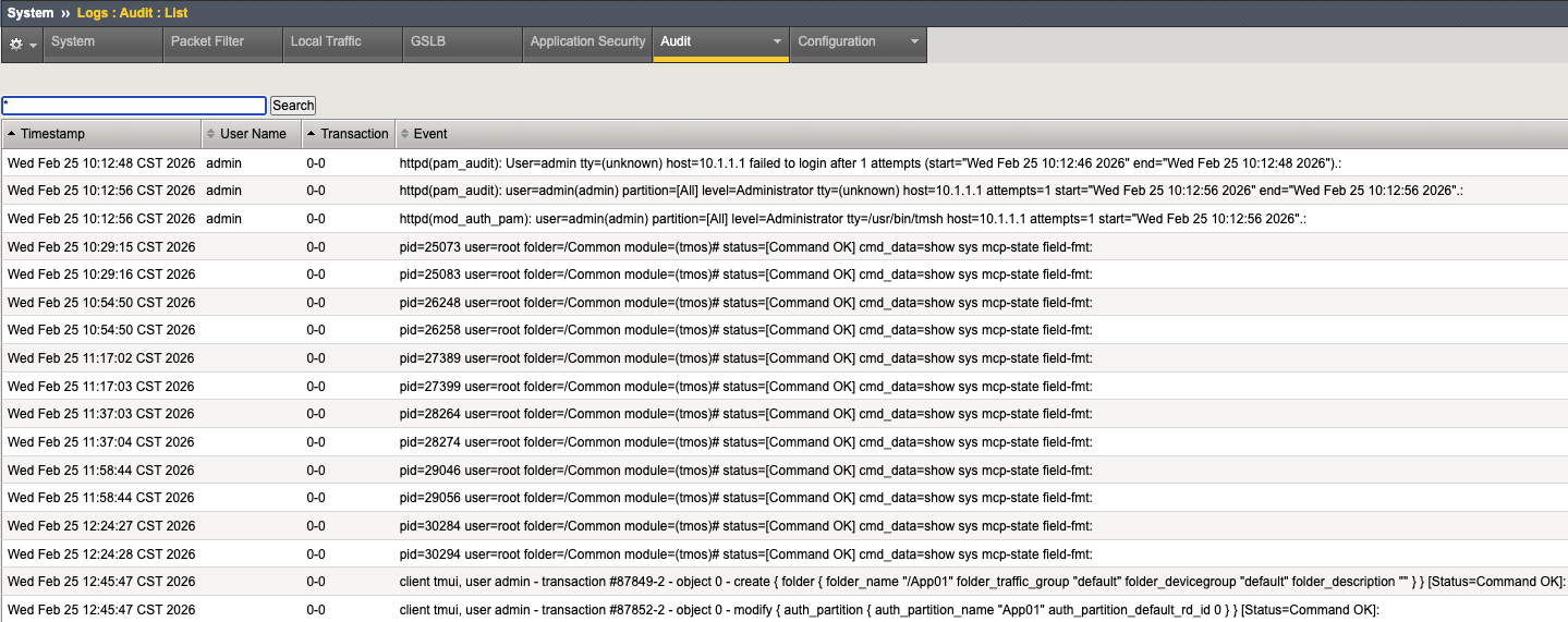

  3. Hover over the Audit tab, then click List
    ../../../_images/audit-1.png
  4. You should be greeted with a screen similar to this:
    ../../../_images/audit-2.png

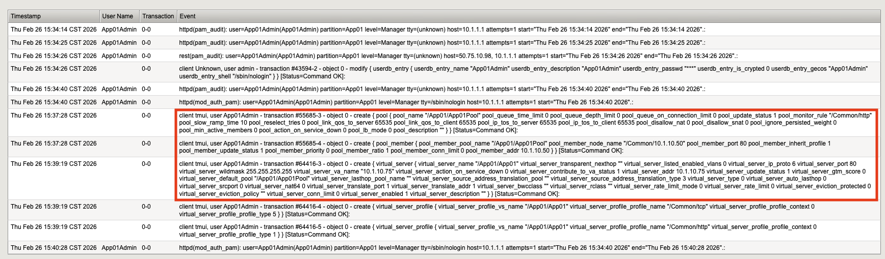

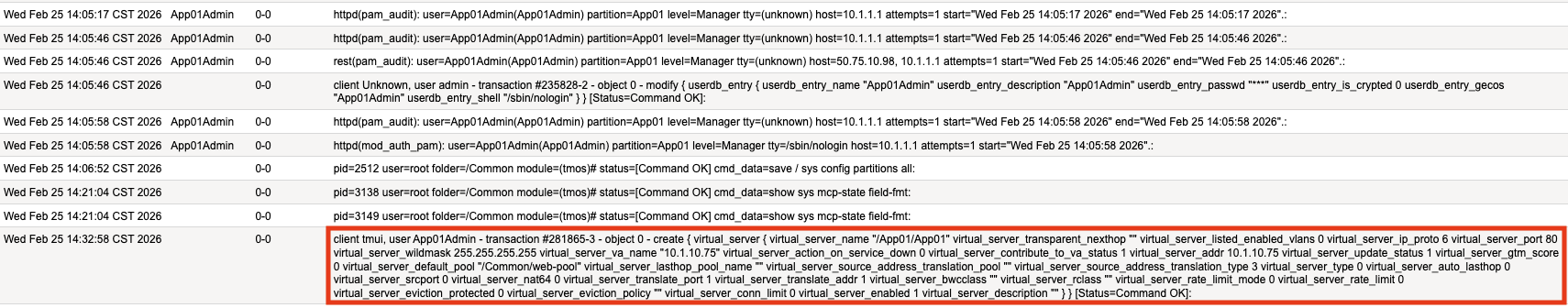

  5. If you scroll through the logs, you should be able to see the actions you took in the previous labs. Some examples below:
    ../../../_images/audit-4.png
    ../../../_images/audit-5.png
  6. See what else you can find. You may notice that many of the the audit trail events are represented as TMSH commands.

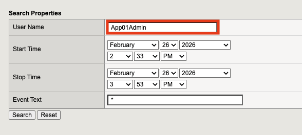

  1. Hover over the Audit tab and click Search.
  2. Replace the asterisk in the User Name field with App01Admin:

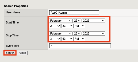

  3. The search criteria will automatically be populated with the current date and time. Be sure to adjust accordingly so that you can see events from the prior lab then click Search
    ../../../_images/audit-7.png
    Important
    Double check the time zone that the BIG-IP is set to. As of this writing, the lab was configured in PST. The time zone is visible at the top of the screen.

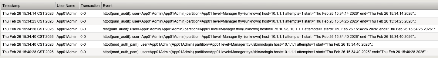

  4. You'll notice that you don't see any of the object creation events in the audit log:
    ../../../_images/audit-8.png
    Important
    This is because the TMUI is executing commands on behalf of the user and the username is not logged in the User Name field.

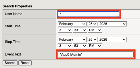

  5. Return to the search box and replace the username with an asterisk, then replace the event text with *App01Admin*. Click Search again.
    ../../../_images/audit-9.png
  6. You should now see your pool, pool member, and virtual server creation events:
    ../../../_images/audit-10.png
