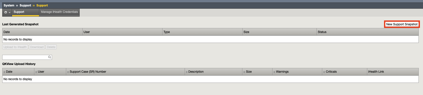

  2. Navigate to System -> Support.
  3. Click New Support Snapshot in the upper right-hand corner.

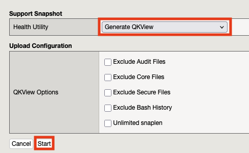

  4. Select Generate Qkview and click Start.

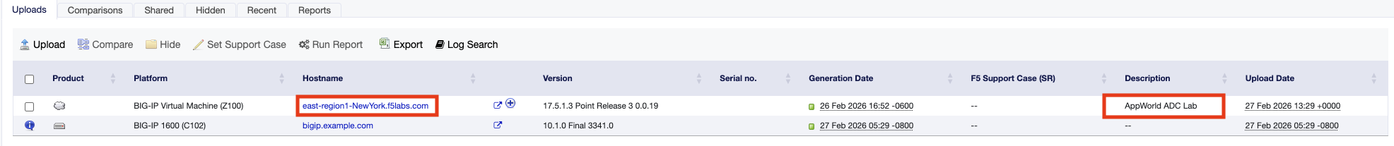

  1. Once the QKView is availabile, go ahead and click on its description:

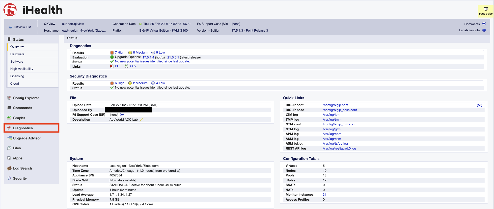

  2. You should be greeted by a screen that looks like the one below. Familiarize yourself with the information avaiable on the main screen, then click Diagnostics in the menu to the left.

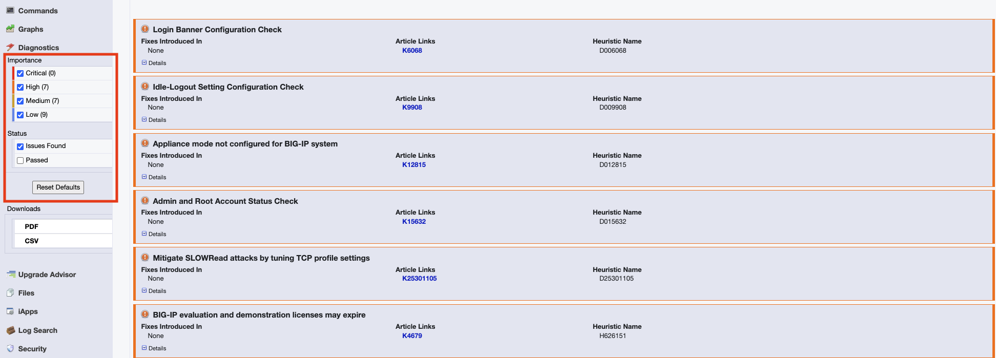

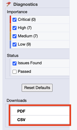

  3. The diagnostic tab is perhaps one of the most important and useful functions of iHealth. It is also one of the easiest to use. This menu presents you with a list of configuration and security issues (including CVEs) that apply specifically to the system that the QKView came from. The menu on the left allows you to show or hide alerts based on their criticality.
    ../../../_images/ihealth-11.png
  4. Below the filter menu, you'll see that there is also a download menu. It allows these alerts to be exported as either a PDF or a CSV. Feel free to explore this option if you're interested.
    ../../../_images/ihealth-12.png

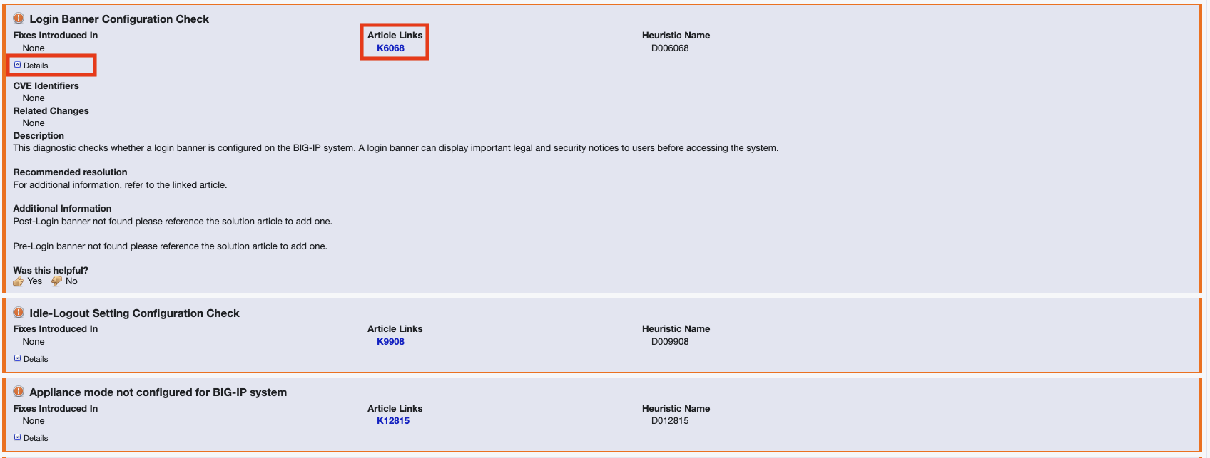

  5. Take a look through the detected issues. Select one and expand it by clicking the details button. This provides further information about the issue, as well as links to impacted objects in the configuration (if applicable). Any relevant knowledge base articles are also linked to each alert.

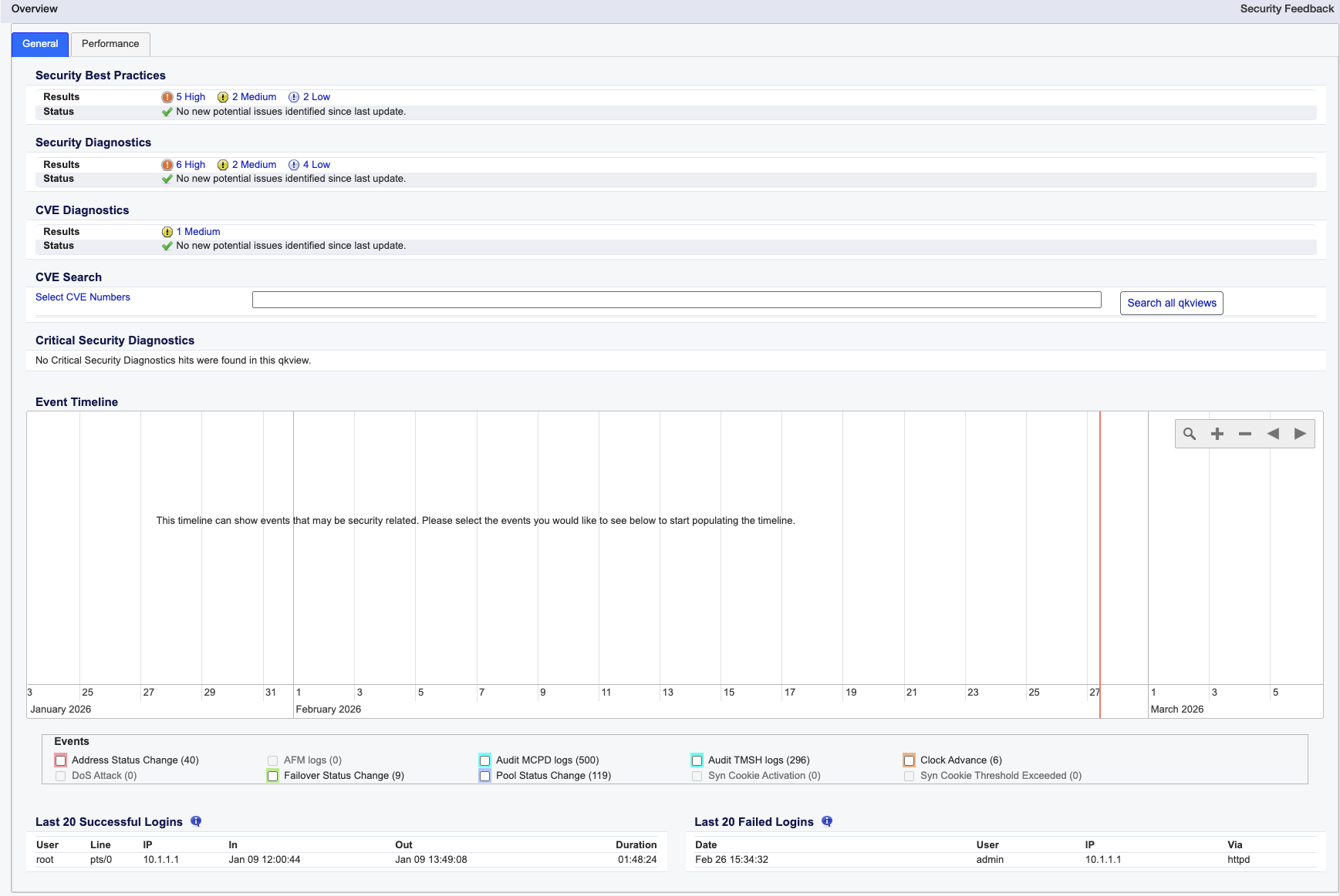

  6. Navigate to Security -> Overview.
    Important
    As noted in the menu, this feature is in beta and may be buggy or otherwise not appropriate for production use. Double-check any insights it provides before taking action.
  7. This screen summarizes the security posture of the system in question. It summarizes applicable CVEs, failed logins, and even DoS attacks against the system.
    ../../../_images/ihealth-14.png
