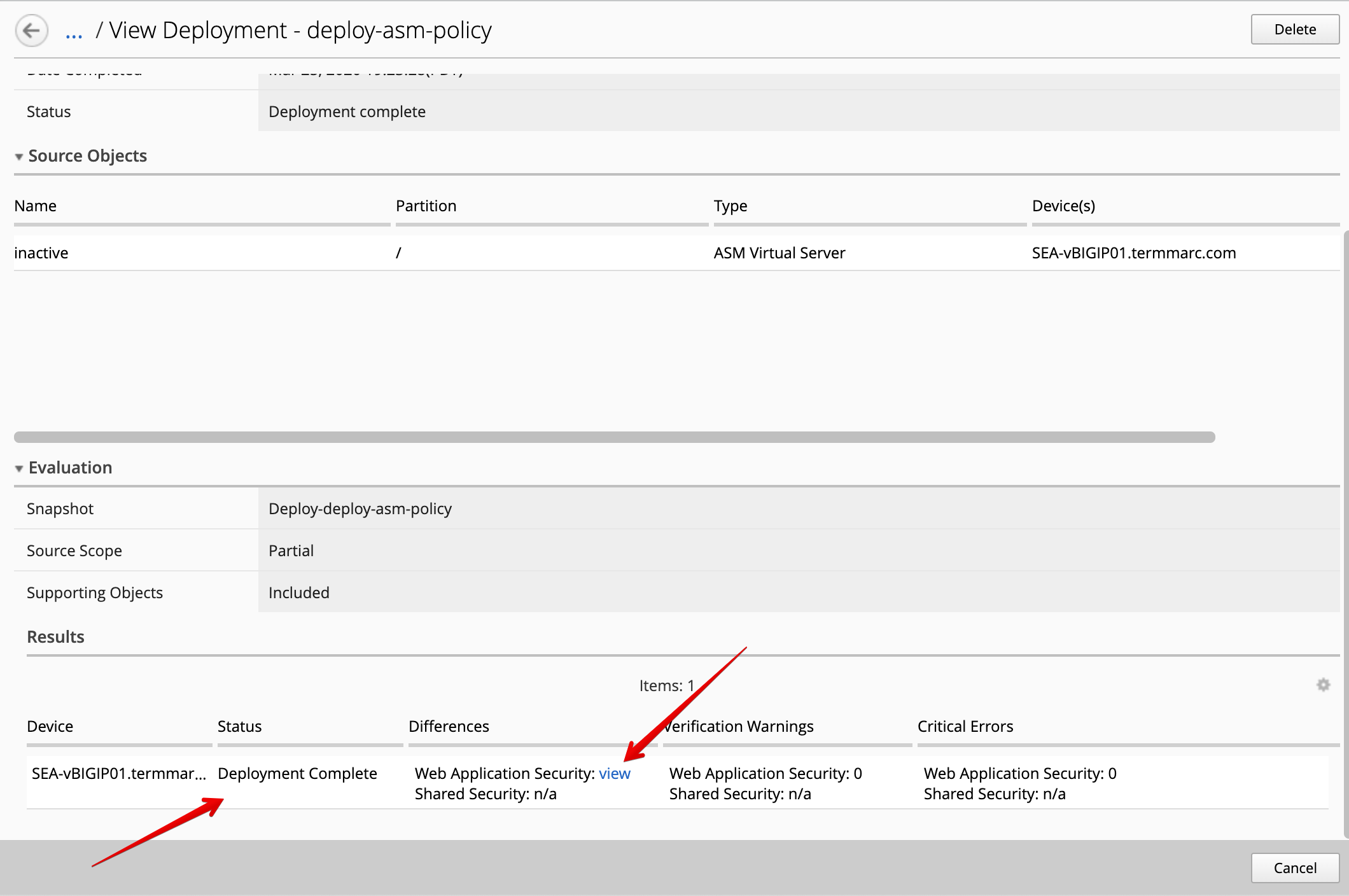

virtual servers attached to SEA-vBIGIP01.termmarc.com, click on Deploy.
- The deployment window opens. Type a name, select
Deploy immediately
for the Method.
Under the Target Device(s) section, click on Find Relevant Devices
and select the SEA-vBIGIP01.termmarc.com. Then, click on Deploy.
- Confirm the deployment information, click on Deploy.
- Wait for the deployment to complete.
Once the deployment is completed, you confirm the changes by clicking on view*.
